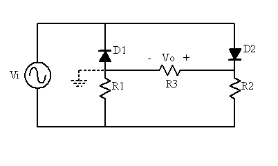

Sketch Vo for the network shown (see attachment) and determine the dc voltage available.
Vi is a sine like wave with amplitude of 100 V and goes on for one period.
When Vi is positive, the diode on the right goes directly to Vo so Vo is the same as Vi during the first half period. The second half period Vi is negative and goes down to -100. The diode on the left is on and Vi goes directly to ground so Vo is zero.
I think this was way to easy and I'm doing something wrong. Any help would be nice.

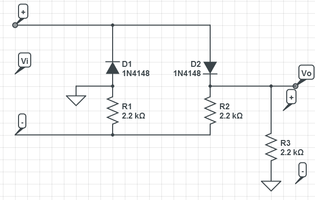

Sketch the path that current follows for the half-cycle where the + terminal is more +ve than the -. Determine the peak value of the current in R3 during this half-cycle. (Ignore the diode drops.)

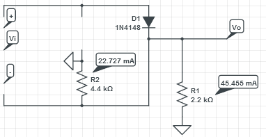

Well when Vi is at it's peak positive voltage of 100 V the diode on the left is in the off state and acts like an open circuit. The diode on the right side is in the on state and allows current to flow though. The resistor branch on the right has 45.455 mA flowing through it and Vo = 100 V. The resistor branch on the left has 22.727 mA flowing though it. I have attached a picture of the diagram with these results.

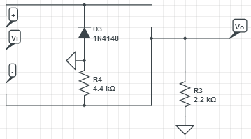

I guess my confusion lies when Vi is in it's lowest negative voltage of -100 V. The diode on the left side is in the on state and current is allowed to flow through it. The diode on the right side is in the off state and acts like an open circuit. The current through the diode on the left goes straight to ground though or does it flow through the 4.4 K ohm resistor branch and up to Vo and down to the 2.2 K ohm resistor branch? I'm also attaching a picture of this diagram.
Oh... when Vi is at it's lowest negative voltage of -100 V the resistors are in series and form an equivalent resistance of 6.6 Kohm. There is a total of 15.152 mA flowing from the 2.2 k Ohm resistor with the positive and negative terminals labeled. As a result Vo is at (.0151)(2200) = -33 V?
It's negative because previously it was positive in the other direction.

It would have been much better had you not renamed elements each time!
You are nearly right. I suggest that you draw the complete current paths on the full circuit, in doing so you should see precisely which resistors are in a series path.
GP: You left out a resistor in your 1st drawing. NO: Can one assume that the Earth connections are connected to the - line?

You cannot assume that.
NO:Do we take the Earth connections to be at zero volts then?
GP: Ok, I see now. You combined the 2 resistors into one of 4.4k, but I think some of the current would also branch off to the - input terminal.
Sometimes a little rearranging of the layout can help with understanding. Here's the same circuit with the tricky ground connections replaced by obvious wire connections.
