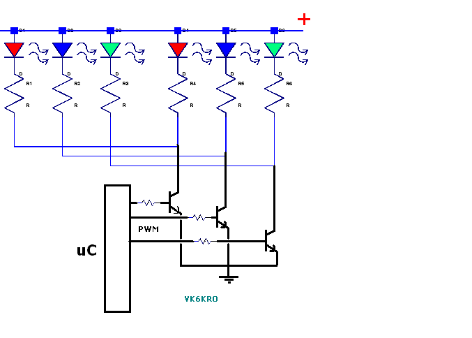

Hello,
I'm very new to designing and building electronics involving anything outside of simple Transistors, resistors, capacitors, and diodes. I have a fair amount of experience with the parts previously listed and they may be the only parts I need for the task I am currently requested aid in building because I am incompetent when it comes to apply the simple knowledge I know in electronics. I am attempting to build a circuit which will drive about 80 5mm RGB LED lights in syncronized slow on/off oscillation. To specifiy the term slow on/off oscillation, I am hoping to use a circuit which will provide DC power to these lights which gradually increases magnitude and then decreases in magnitude so that the intensity of the lights will oscillate as they change color. These RGB LED's possesses a common anode so I was also hoping to implement some IC which randomly distributes the electricity to each color cathode so that a syncronized yet new color is generated by the 80 LED's with every slow oscillation of color.
Esentially I am asking what circuit would generate a Sine wave or sawtooth DC signal, and is there an IC which can randomly distribute this signal across different anodes? I know that this can probably be accomplished with a PIC or a microcontroller but i have no experience with either of these parts.

I doubt if any ready made chip is going to suit what you want. There has to be some demand before producers will make something like that.
That is why micros exist. They have a powerful set of tools in them and can do the job you want easily and cheaply.

Do you want all LEDs to be the same colour at the same time, or do you want each to be controlled individually with random colours? The latter is more complex and will require more components, of course.

"Do you want all LEDs to be the same colour at the same time, or do you want each to be controlled individually with random colours?"
Well I was hoping that all of the LEDs would project the same color at the same time, but I plan to have three or four separate panels of LEDs displaced throughout the room so I hope that will not create any problems. Effectively I am attempting to make some cool mood lights.
Circuit schematic of six LEDs in three red, blue and green pairs, each with a series resistor R1 to R6, switched by NPN transistors driven from a microcontroller uC labelled PWM.
Circuit schematic of six LEDs (red, blue, green, red, blue, green) in parallel from a + rail, each with a series resistor R1 to R6, switched by NPN transistors driven from a uC labelled PWM outputs.
You would probably need something like the above. It shows two RGB LEDs with the same colours being switched by a transistor and the brightness of each being controlled by a PWM output of a Micro.
I have a small doubt here. It is possible that the PWM sources could beat with each other in the LED and produce a strobing effect which would not be very relaxing.
If that happened, some filtering at the base of the transistors might be able to get rid of the effect.
