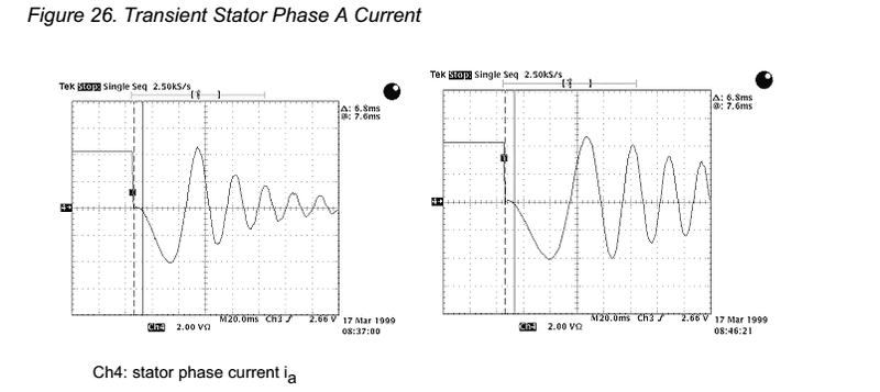

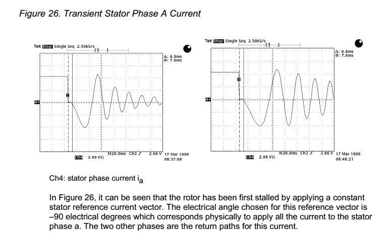

I was referring to the following statement in the document which confused me and also attaching the document for your reference. "First, we need to know the rotor position. The position is typically related to phase A." How the above statement is true. Please help me to understand. I am assuming that Phase A is current here. The statement is on page 1.
It's a definition, not a calculation.
It's just the choice of a reference point. You measure rotor's angular position from some agreed on point .
Where do you choose to place your zero degrees mark?
Author chose centerline of phase A for his zero.
Next couple sentences describe it.

alignment. During the alignment, the
rotor is aligned with phase A...

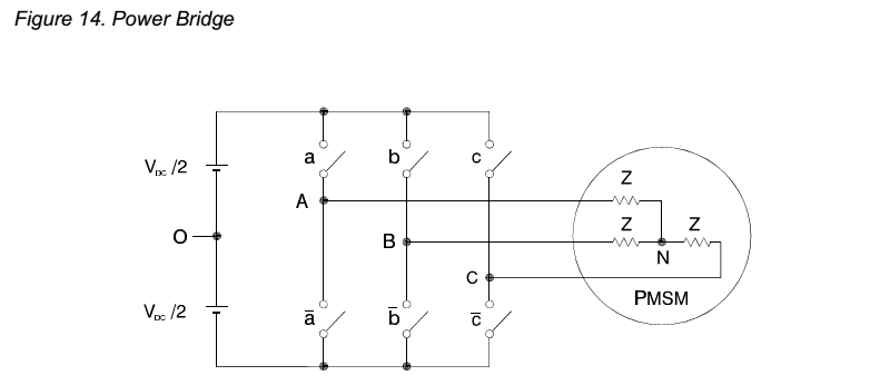

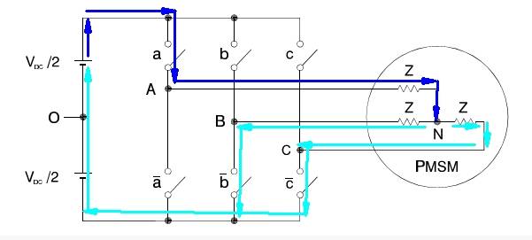

So much thank you for your time. I am completely following the attached document and implementing it. Your reply has helped me to clear few doubts. Could you please review my understanding. My system is a Permanent magnet NMEA motor and i get the feedback from an encoder attached to it. After discussing with you and after seeing the following picture in the attached document.
Step1: Apply a constant voltage to phase A by switching on switch "a". This will make the motor rotate and align with phase "A"
Step2: When received the motor command and based on the requested Torque (I). Apply the transformations and derive the voltage to be applied to the stator. Using the space vector modulation apply the the pwms to the switches.
Step3: once the motor starts rotating get the encoder pulses and from this identify the rotor position. This will be the electrical angle.
Very briefly am i correct in the understanding? Please help.
I have doubts regarding the I nominal. what does it represent? How much value should I take?

1. Two 'switches' in addition to 'a' must be closed to lock the rotor to a "zero", home position.
In this example, the closed switches are a, not b, and not c.
The drives I'm familiar with employed current limiting when the output bridge was so configured to prevent motor windings from overheating and burning up.

Thank you both for the replies. Yes what you said is correct i need to close the not b and not c. Yeah i have gone through these videos a number of times and have been reading about FOC for a long time. I thought i understood the concepts. Do you feel i still need to learn some more concepts? Any particular area where i can concentrate? Please suggest.
