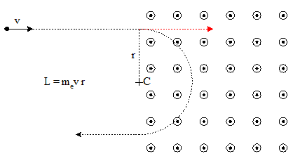

Consider the following experiment from the point-of-view of classical mechanics and classical electromagnetism: An originally free electron then passes through a magnetic field that is oriented so that it causes the electron to turn to, say, the right. During the “turning” of the electron (a finite time interval), does it temporarily possesses classical orbital angular momentum?

I'm not sure if there's any technical distinction between regular "angular momentum" and "orbital angular momentum", save that one is associated with an orbiting body.
Before the electron even enters the region of the magnetic field it already possesses angular momentum about the future center of the circular arc.
As @gneill notes: It has angular momentum even when it's moving in a straight line, around any point not on that line.
Thanks, I forgot just how general the definition of classical angular momentum was.
