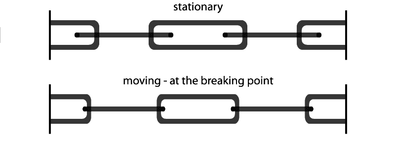

https://en.wikipedia.org/wiki/Ladder_paradox#Ladder_paradox_and_transmission_of_force
It helps to think of the ladder as two boulders with a spring between them. There will be a compression in all frames.
Now if Bell's "rope" is a 3 boulders with springs between, then once the two spaceships begin their acceleration, there should be some initial stress as the center boulder remains briefly in place while the end boulders start accelerating with the rockets (all in platform frame). Since the center boulder never has a direct acceleration from a rocket engine, I imagine it is always somewhat behind from the midpoint of the other two boulders.

Am I missing something? Something like "both rockets are some way forced to accelerate with respect to the initial reference frame (maybe)?
3. Both rockets are tied by an elastic string, which will break if the strain as measured in its momentarily co-moving frame reaches the elongation to break.
4. The string will break at a certain moment, and as interpreted in S, this is due to length contraction because the distance between the rockets remains constant in this frame. Length contraction refers in this context to a change of the stress-free length of an object as observed from a single frame.
  • #59
Nugatory said:
To do that, you'll need to know how rapidly they are moving apart, and the easiest way to do that is start with their trajectories in the frame in which their acceleration are "truly uniform" (your words, not mine) and then transform into a frame in which one or the other end of the string is at rest. That way, length contraction never enters into the problem, and you can analyze the behavior of the string using only well-understood classical materials science.
Surely inertial frames, comoving or not don't come into the problem. As Nugatory says - transform to the local frame basis of anyone of the ships and it becomes clear that the ships ahead are getting further away and the trailing ships are falling further behind. This stretches the string.
  • #60
In which sense that is correct and in which sense not, was the subject of the elaborated discussion here above - starting with Nugatory's post #48 .
