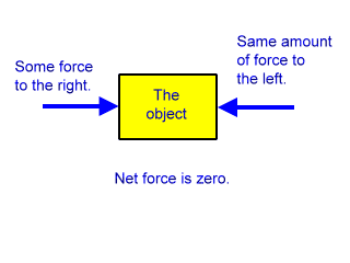

Only difference is we are using energy instead of force then calculating in (X,Y,Z) to get the grand total from all sources.
You appear to be assuming that the net force is zero. That's not the case; if it were, the ship would not be accelerating.

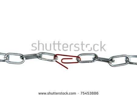

It will break at the weakest point near that location predicted though.
You don't know where the "weakest point" is unless you have a model of the material properties and internal stresses of the string. You can't build that just from relativistic kinematics.
Also, "weakest point" is a misnomer; the simplest material model of the string would have its properties uniform, meaning there is no "weakest point"; all the points have the same tensile strength.

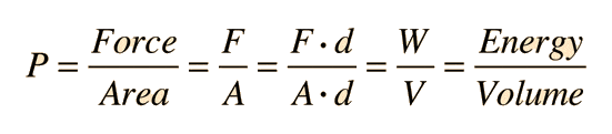

Don't make me actually calculate this and it snaps when the Energy-mass of the volume goes above the Max Tensile strength in that Energy/Volume.
Yes, that's true. But it's not what you said before. If it was what you were trying to say, you weren't making it clear.
