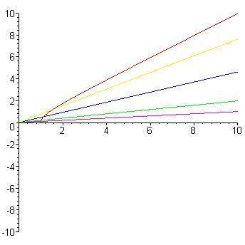

As I mentioned in another post
[tex] t = (1/g + \chi) \mathrm{sinh}(g \tau)[/tex]
[tex] x = (1/g + \chi) \mathrm{cosh}(g \tau)[/tex]
(t,x) are the inertial coordinates
[itex](\tau,\chi)[/itex] are the "POV" coordinates.
Plot the lines of simultaneity ([itex]\tau = constant[/itex])
Let the acceleration, g, be 1 for simplicity.
Then at [itex]\tau=0[/itex], the lines of simultaneity are given by the expressions
[itex]t = (1+\chi)[/itex]
[itex]x = 0[/itex]
Plot this parametrically - you'll see a horizontal line, x=0, as you'd expect.
Now let's evaluate the expression at [itex]\tau=.1[/itex]
You get approximately
[itex]t = (1+\chi)*1.005[/itex]
[itex]x = (1 + \chi)*.1[/itex]
Plot these parametrically - you'll see a slightly tilted horizontal line. This line starts at the location of the spaceship at t=.1, and has a slope of .1
Eventually these coordinate lines cross (the lines for tau=0 and tau=.1), this happens at x=0. (But the ship is at x=1).
See the attached plot. The single curved line is the plot of the ships position (it starts at x=1, t=0). The various straight lines are lines of simultaneity at tau = .1, .2, .5, and 1
I've talked at length about the significance of the coordinate lines intersecting previously - basically, multiple coordinates get assigned to the same point. This is rather ill-behaved, but perhaps not fatal. I usually don't use coordinates in this region, just because they act strangely, so I may not be aware of all the pitfalls of such usage. You are the person who wants to assign the ontological status of "reality" to coordinates, whereas I regard coordinates as being observer dependent, and thus in a sense not really "real". You are also the person who wants to use the coordinates beyond the point where they overlap - I'm the person who is leery of such usage. So when you complain about how weird they act, I tend to think "Then don't do it!"

The Faq is trying to tell you that while the accelerations of the two spaceship appear to be the same in the lab frame, the accelerations of the two spaceships do not appear to be the same in the non-inertial coordinate system of the spaceships themselves.
The "upper" spaceship will appear to have clocks that tick faster than the lower spaceship, due to "gravitational time dilation". Gravitational time dilation occurs only in non-inertial frames, but the accelrating spaceships coordinate systems are just such frames.
Both spaceships will agree about this, in the accelerated frame higher objects have clocks that tick faster than lower objects. Because of this clock rate difference, coordinate accelerations will not be the same between the two spaceships.
In the problem as specified, the front spaceship will always have a greater coordinate acceleration than the rear spaceship.
This means that any string connected betweent the two spaceships will break as the spaceships pull apart.

We just got through a long derivation in another thread for a more complicated version of the problem you are talking about.
https://www.physicsforums.com/showthread.php?t=110742
In this thread it is derived that if the equations of motion for an accelerated obserer are
x = cosh(g*tau)/g
t = sinh(g*tau)/g
(note- this is correct, my post #3 has a typo that's too old for me to correct that interchanges x and t)
then the equations of motion for a "stationary" observer with respect to x and t can be most simply written as
x' = cosh(g' * tau) / g'
t' = sinh(g' * tau ) / g'
where g' is not equal to g. (There is an alternate form of the equations of motion derived in that thread, but later on it is pointed out that they only look different than the above, that they are mathematically equivalent).
The description of these curves is that they are all hyperoblae which share the same "hyperbolic point", which gives rise to the name "hyperbolic motion" for the motion of an accelerated observer.
Just in case you didn't know, cosh(x)= (e^x + e^-x)/2
while sinh(x) = (e^x - e^-x)/2, these are the hyperbolic trig functions.
What this means is that the "stationary" rocket will have a lower proper acceleration depending on its height, where the proper acceleration is the aaccleration read by an accelerometer mounted on the hovering rocket. Mathematically the proper acceleration is derived by taking the magnitude of the 4-acceleration, which is just the deriviative of the 4-velocity with respect to proper time.
(I don't know if you know much about 4-vectors. They are used througout the above thread, though, and are an essential tool of special relativity.)
The higher the "stationary" rocket, the lower the (constant) reading on its accelerometer. If the "stationary" rocket is below the reference rocket, it actually has to accelerate harder. This acceleration increases towards infinity as the stationary rocket nears the hyperbolic point located at the origin of the coordinate system, a distance c/g "below" the reference rocket. This point also marks the plane of the "Rindler horizon", which I think I've talked about before (?).
