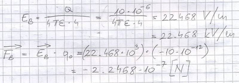

Here is the attempt at a solution, and here are the correct answers.
EDIT: I can't find what I'm doing wrong but I'm not sure how do I get Eb from Ebx and Eby.

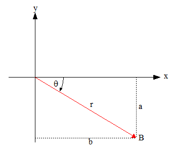

That's kind of the long way to get to Eb. You are given enough information to find the force magnitude and angle separately.
You can determine the length of the vector r easily enough from the given components. From there you can find the magnitude of the electric field. You can also determine the angle θ from the components.
It looks like I'm forgeting something. Where do I use the angle θ?
The field and force are both vectors. Thus they have magnitude and direction. A vector can be expressed in Cartesian component form (i, j, k components), or in polar form (magnitude and angle). Finding the polar form for the field and force at point b is straightforward.
In post #4 the red vector represents the position vector r for point b. You can find its magnitude and angle by Pythagoras and a bit of trig using the side lengths of the triangles formed.
The electric field magnitude depends on the distance magnitude (Coulomb's Law formula). The angle will be the same as for the position vector. Similarly the magnitude of the force on some charge q placed at location b can be found using the magnitude of the electric field there. Again the angle associated with the force vector will be given by that of the electric field angle (and position vector angle). The only caveat to that being if the charge is negative then the direction of the resulting force will be flipped in direction 180°.

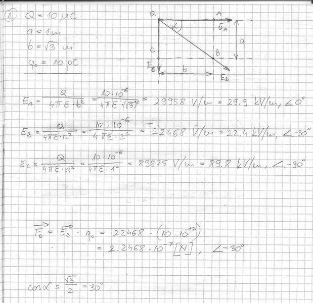

That looks good.
