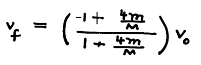

IS my solution right? Comparing with the other solutions, the answer just exchange the signals, i don't know why,
THats what ifound.
And here is the three equations:
{i use the point which occurs the collision}
Lo = Lf >>
0 = Iw + M*Vcm(block)
Eg = ct>
mvo² = mvf² + MVcm² + Iw²
I = ml²/3
P = cte
mvo = mvf + MVcm
I just assumed that xyz dextrogira, i thought that putting by this way, the math would implies the correct values, that is, we would find w<0, and the others values. Apparently i am wrong in something, where?

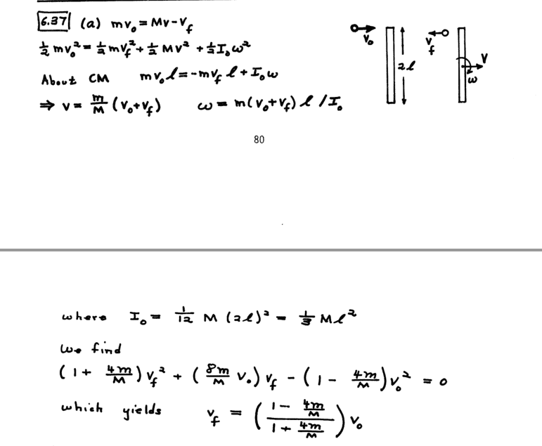

I get the same answer you do.
Please post the book answer exactly as given.
As you can see, in our answer the numerator has signals exchanged.
You have a different sign convention for ##v_0## and ##v_f##. What's up with that? If you are trying to explain a sign error in the answer, the very first place to look is at the sign conventions.
Yes, but in this case it is rather surprising that they reversed the sign convention for vf. Which way the ball goes after collision depends on how its mass compares with M/4, so it would have been far more natural to have kept the positive direction the same.

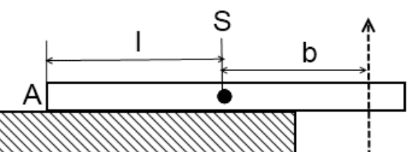

Sorry for offtop, perhaps somebody will be interested.
I remember a much funny problem of the same type. A plank of mass ##m## and of length ##2l## lies on a smooth horizontal table as it is shown at the picture. Here ##S## is the center of mass. A bullet punches through the plank (dotted arrow) and loses linear momentum ##p##. Find the angular velocity of the plank right after the punch. It is not so trivial as it looks from the first glance.
Likes etotheipi
Depends whether b>l/3, right?
yes :)
1. Why do they reverse the sign convention for vf when it is a velocity with a direction.
2. Doesn't it say that " assuming that mechanical energy is conserved
and that vf is along the original line of motion "?
3. Are vector arrows meant to be drawn on vector quantities?
4. If we just draw vector arrows on the equation that OP supplies, is there any need for changing the sign now?
I assume whoever wrote that solution considered rebound as the expected behaviour, but there is no good reason.
You are asking us to guess about a decision made by someone else. I do not agree with that decision, but I can try to defend it anyway.
Often, one will try to choose a sign convention so that all of the numbers in the problem will be positive. So if one expects the initial velocity to be toward the right and the final velocity toward the left then one might want to choose a sign convention so that positive values of ##v_0## are rightward while positive values of ##v_f## are leftward.
Of course, this means that when those values are combined in an equation, the difference in sign must be accounted for. So instead of writing down a conservation of linear momentum equation like$$mv_0 + Mv_0 = mv_f + MV_f$$we have to write$$mv_0 + MV_0 = -mv_f + MV_f$$.
If we do not know, when initially approaching the problem, what direction the final velocity is going to have, it is more sensible to use the same sign convention (or, more generally, the same coordinate axes) for everything. If that means that the numeric velocity comes out negative, so be it.

The trick in the question is you have to consider two possibilities. If the impact is sufficiently close to the rod's mass centre, the rod will rotate relatively slowly, so the end that was on the table will rise off the table. If the impact is sufficiently far from the rod's mass centre, the rod's rotation could be so fast that the end at A would move down into the table; to prevent that there must be a normal impulse at A.

We seem to be at cross purposes.
In post #13 I wrote that ##\vec {v_f}=\frac{1-\frac{4m}M}{1+\frac{4m}M}\vec{v_0}## would be wrong.
##\vec {v_f}=\frac{-1+\frac{4m}M}{1+\frac{4m}M}\vec{v_0}## would be correct.
