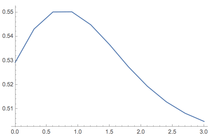

Problem: I'm interested in studying the probability of an event involving a random vector.
Specifically, I'm interested in
(∂/∂a)Pr[X>( (Y-a)/Z )]
Where "a" is a non-random parameter and the random vector {X,Y,Z} is distributed Normal( µ, Σ)
for µ={0,0,0}
and Σ= {{1, 0.5, 0.5}, {0.5, 1, 0}, {0.5, 0, 1}}
What I know: Simulations tell me that the above partial derivative is non-monotonic, i.e. increasing the value of "a" first increases the probability of the event, and then decreases it. Attached is a simulation for a∈[0,3].
I can see that this is likely coming from the fact that Z takes value along the real line, so the effect of "a" flips with the sign of Z.
Question: I struggle to understand exactly what is going on here from a distributional point of view. What determines the point of inflection? I don't need an analytical solution – just some intuition.
  • Line graph of a probability against a from 0 to 3: it rises from about 0.529 to a peak near 0.550 around a=0.6 to 0.9, then falls to about 0.505 at a=3.

What I know: Simulations tell me that the above partial derivative is non-monotonic, i.e. increasing the value of "a" first increases the probability of the event, and then decreases it. Attached is a simulation for x∈[0,3].
Did you mean "for ##a\in [0,3]##" ?

The vector μ and the matrix Σ refer to the parameters of the joint distribution of (X,Y,Z). The simulation is fixing all of these parameters, and tracing the probability for different values of "a".
I suggest we start by seeing if we can get intuition for a much simpler situation!
Let ##Y## and ##Z## each be uniformly distributed on the interval [-1,1]. Let ##x## be a number instead of a random variable. How does ##P(x > (Y- a)/Z## vary with ##a## ?. Maybe we need to consider two cases: ## x< 0## and ##x > 0##.
It might be simpler to ask about ##P(x < (Y-a)/Z)## since that's a question about a cumulative distribution.
