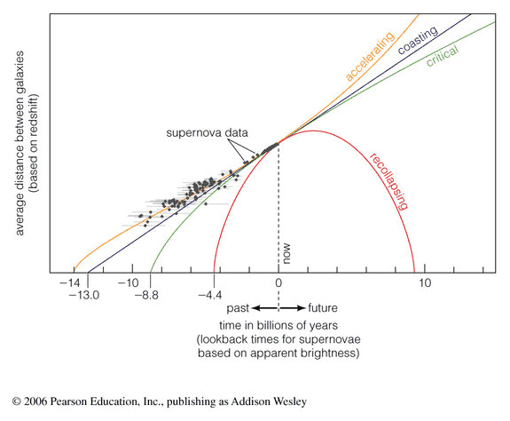

In the diagram the yellow curve represents the L-CDM model. The slope decreases til point "now" (where matter density and ##\Lambda## cancel each other) and then increases.
Would decreasing pull between objects (instead of ##\Lambda##) also cause the slope to turn from decreasing to increasing? Or would it cause the slope to decrease for ever? In the latter case Deur's model would predict a decelerated expanding universe meaning that the L-CDM model predicts an accelerated expanding universe erroneously.
If have no good intuition here. What do you think?
