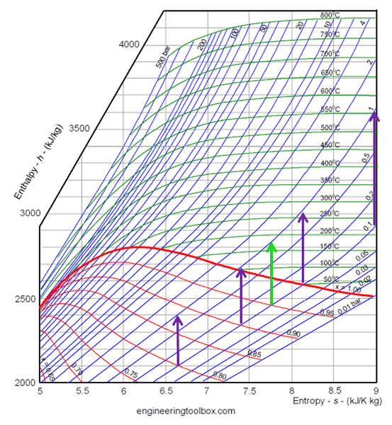

For the purposes of this discussion you should consider Enthalpy a physical parameter of the fluid like temperature or pressure. I think you might be getting a little wrapped around the axle regarding its significance in a thermodynamic process. It is a combination of the internal energy of a working fluid, plus the product of pressure and volume of that fluid.
Chester has shown what I would consider a herculean amount of restraint and patience in this thread and I'm amazed it's stuck around this long actually. For your question regarding compression of a partly saturated fluid, I personally would stick to being a practical engineer and use a t-s , h-s. or possibly p-v diagram for steam. Take for example this one:
http://www.gemco.fr/medias/MollierDiag.png
Say I have 50% saturated steam at 10 Bar (approx 180 Celsius at this state) and want to know what would happen if I compressed to 100 Bar.
  • As a first assumption, I would estimate the compression cycle to be isentropic and follow a constant-entropy line (vertical line on a T-s diagram) from state 1 (10 Bar) to state 2's pressure (100 Bar).
  • A quick eye estimate looks like this would result in approximately 42% saturated steam at 100 Bar (with a resulting state 2 temperature of about 310 Celsius).
  • This compression process also increases the specific enthalpy of the fluid from a little under 1800 kJ/kg to a little under 2000 kJ/kg, it looks to be a change of about 200 kJ/kg.
I personally prefer to see thermodynamic cycles in the context of these diagrams, so I can "visualize" what's going on; maybe it can help for you as well?
