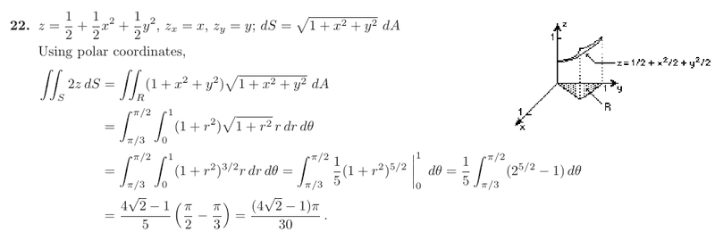

Textbook problem: evaluate the surface integral of G(x, y, z) dS, Problem 22 with G = 2z over the part of paraboloid 2z = 1 + x^2 + y^2 in the first octant bounded by x = 0, y = sqrt(3)x, z = 1.
Handwritten-style math solution computing a surface integral of 2z dS over a paraboloid using polar coordinates, with a 3D sketch of the paraboloid z = 1/2 + x^2/2 + y^2/2 and shaded region R in the xy-plane.
I am having difficulty understanding how the author determined the limits of integration of ##R##. The author used ##\theta=\pi/3\quad to\quad \theta=\pi/2## and ##r=1\quad to\quad r=1##. More accurately, I'm not even sure how the author graphed ##R## in the diagram. Where did he get the shape of ##R## from?
R is the projection of the paraboloid onto the XY plane. The surface boundary is given in the question by the lines x=0, y = x√3, z=1. Since 2z = 1 + x2+y2 for the surface, that last translates into 1 = x2+y2 for R. So R's boundary consists of two straight lines and an arc of a circle.
If θ is measured from the +ve x-axis, what are its values at the two straight lines?

OK, I think I got it, but that was ridiculously complicated.
