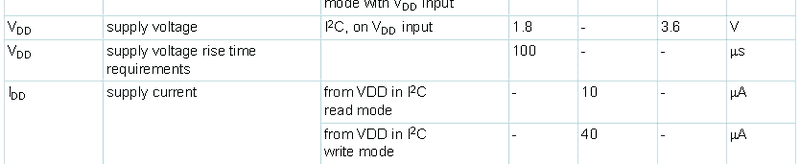

and i don't know how you'll power that. If i read right you might get a few microamps from the VDD pin but I'm at a loss what they mean by "I2C on VDD pin". Seems unnatural to use same pin for power and communication.
Here's a snip from the datasheet http://www.farnell.com/datasheets/1996754.pdf section 13
Must be somebody here more current than i am on these things.
I've only used I2C once twenty years ago with a traditionally powered 5 volt microprocessor. Used a Maxim DAC to produce analog voltage from a digital value i handed it via I2C from my microprocessor.
You need to go the other way, digitize with an ADC then hand the value to RFID processor via I2C.
