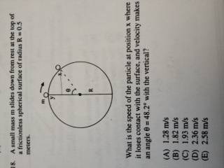

A small mass m slides down from rest at the top of a frictionless spherical surface of radius R=.5 meters. What is the speed of the particle at position x where it loses contact with the surface, and velocity makes an angle of θ=48.2 with the vertical?
The answer choices are:
(A) 1.28 m/s
(B) 1.82 m/s
(C) 1.93 m/s
(D) 2.36 m/s
(E) 2.58 m/s
Conservation of Energy?
I thought maybe start with PE1=PE2+KE, where h=2r, and then find the cosine component of the height when velocity is at that angle, to do: mg(2r)=(1/2)mv2+mg((cos48.2)+R), but that didn't work. I got .57, which is not even close to any of the choices.

Hi Victorzaroni
try equating component of weight with centripetal force
Component of weight as in the cosine component or sine?
see at the point when it leaves the contact
mgcos(θ) will be equal to centripetal force o:)
thanks. I get it now! It's 1.82, choice B
