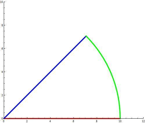

How about I ask you this: See that (closed) contour down there? Now suppose I wish to integrate a function over that contour that is analytic inside and on the contour. Since the function is analytic, the integral from 1 to 10 over the red contour should be the same as if I start at the origin, integrate over the blue, then integrate down over the green to the point (10,0) right? Integrating from 0 to 10 is independent of how I get to the end point. So I could write:
[tex]\mathop\int\limits_{\text{red}}= \mathop\int\limits_{\text{blue}}+\mathop\int\limits_{\text{green}}[/tex]
as long as you're careful to keep straight, the path directions of the integrals. However, if I just integrate over all of them in a counterclock-wise direction, then by Cauchy's Theoerm, since the function is analytic,
[tex]\mathop\int\limits_{\text{red}}+ \mathop\int\limits_{\text{blue}}+\mathop\int\limits_{\text{green}}=0[/tex]
Well, that's the three integration paths you have in i, ii, and iii above. Now, I haven't worked it out but I'd start by just plugging in all those integrals into these two formulas and try to just muscle-through all the algebra to see what happens.

I get what you mean.
But the path in ii does not at infinity. Or I can just change the R to infinity by having limit?
Yes, we let R go to infinity.
