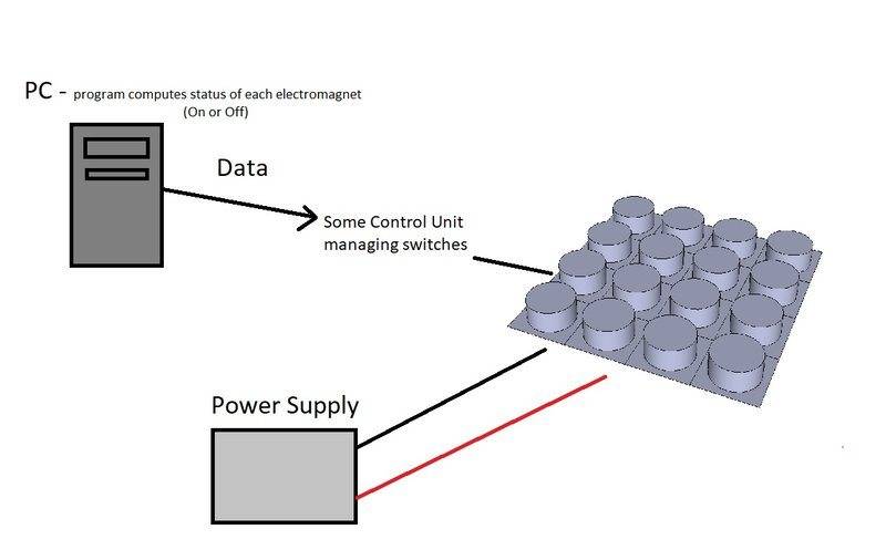

Thanks for the suggestions, I used LEDs as an example of an external device I would like to control, but since I need to be more specific, I would really like to control about 16 electromagnets, possibly more.
I'm not sure if multiplexing would work in this case since only one electromagnet could be on at a time, so some sort of individual control may be necessary.
Let me know what you think, thanks!

First, in a 4x4 with electromagnets, any combination within a single row could be on.
But there are problems. You don't want to connect your PC circuitry directly to an electromagnet. You need some circuitry in between that is more robust and able to withstand current spikes. But you can still set them up in a matrix. Each EM will likely require a cap and diode to keep the current flowing between refresh cycles.
Do you want to build this gizmo - or buy one. There really are many ways to do this.

A Pi3 will kind of work, but that is a little different than controlling with a PC - With a Pi you can make a standalone or PC connected system, but each element makes it more complicated.
OK - so you have 16 or more electromagnets, you just want to turn them on and off, correct?
Anything else?
Could you make a block diagram or something?

Here is a diagram I made that may make things clearer.

A complete (product) like this seems to fit the bill... 24 Channel USB - I/O Module - This is powered by the USB, so see my note below about the ElectroMagnet load.
This can probably be done DIY for about $100. For PC control you can use a USB-GPIO ( General Purpose Input Output) Bridge. With at least 16 channels or Pins available.
Example from Sparkfun
You then need to find out what the power requirements are for the Electromagnets. And develop a simple driver circuit, or possibly a driver IC will work, since the outputs of the interface / controller probably can not support the load of the EMs.

That first product from Amazon seems to be exactly what I'm looking for!
(Although I'm not sure it has an SDK, since I need to write code for it)
I have no problem in developing the driver circuit, all it really needs is a transistor between one of the wires leading to the electromagnet that will control the flow of current, and possibly some EM noise protection.
I'm guessing if I wanted to control even more electromagnets I could just extend my USB ports and plug in more of these devices.
