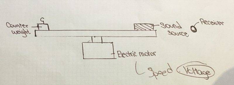

My research question would be The effect of angular velocity of circular motion of a moving sound source on the sound frequency. I am planning to place an electric motor at the bottom and put a stick or ruler on top of the motor. Then, I would put a phone with a controlled sound frequency and a counter-weight on each end of the stick/ruler, a mic will be placed somewhere near the set up. The speed of the electric motor will be changed and see how it affects the sound frequency BUT there is only an AC electric motor in my school where the speed cannot be controlled (so the speed can't be changed).
I have heard that the speed depends on the amount of voltage supplied to a DC electric motor, but is it possible for me to manipulate the speed to run this experiment?

I am afraid hobby motors might be a bit weak if I have to support a 1-meter long wooden ruler or some sort on top of it with a phone and a weight?
I would show you a picture of the set up I am thinking about at the moment but I don't know how to upload photos...

Ooo, thanks. So here is the setup @Tom.G
Yes, a PWM voltage source is used to control the speed of a DC motor.
So by using a PWM I will be able to manipulate the speed of the motor easily?!

Just a thought.
Have you worked out the numbers for how fast the motor needs to spin for a given change in sound frequency? That will be importatnt for selecting the motor.
Two Ideas...
1.) Use gears as a transmission. A multi-speed bicycle can be used for this.
2.) Use a friction brake on the rotating device while keeping the voltage and current to the AC motor constant. Changing the friction work load on the regulated AC motor will vary the speed. ( Remember to use a slip-clutch between the AC motor and the rotating device, or you will overheat and burnout the motor. )

Method of speed control depends on the motor. Many AC motors (synchronous motors) use frequency. DC motors use applied voltage.
