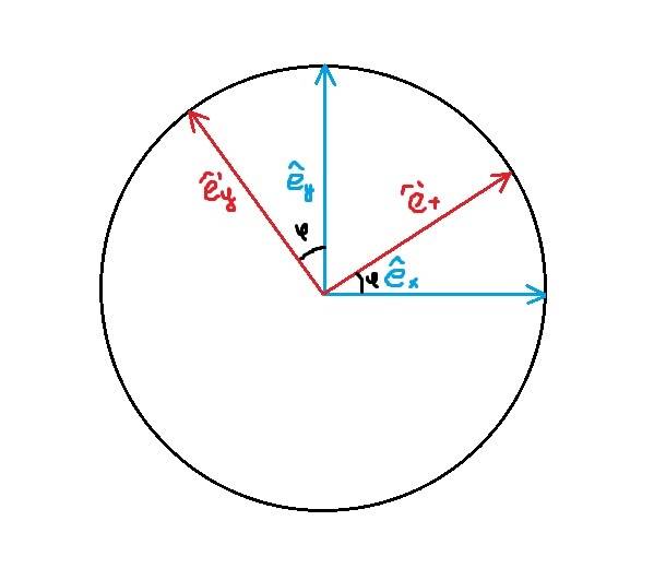

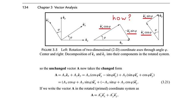

How author derives these old basis unit vectors in terms of new basis vectors ? Please don't explain in two words.
[itex]\hat{e}_x = cos(\varphi)\hat{e}'_x - sin(\varphi)\hat{e}'_y[/itex]
[itex]\hat{e}_y = sin(\varphi)\hat{e}'_x + cos(\varphi)\hat{e}'_y[/itex]​
How about one word? Trigonometry.
It is just a matter of projecting the old basis on the new. Since the new basis is orthonormal, it holds that ##\vec e_i = (\vec e_i\cdot\vec e’_j)\vec e’_j##.

[itex]\vec{e}_1 = | \vec{e}_1 | | \vec{e}'_1 |cos(\varphi) \vec{e}'_1 + | \vec{e}_1 | | \vec{e}'_2 |cos(\frac{\pi}{2}+\varphi) \vec{e}'_2[/itex]
[itex]\vec{e}_1 = cos(\varphi) \vec{e}'_1 -sin(\varphi)\vec{e}'_2[/itex]
[itex]\vec{e}_2 = | \vec{e}_2 | | \vec{e}'_1 |cos(\frac{\pi}{2}-\varphi) \vec{e}'_1 + | \vec{e}_2 | | \vec{e}'_2 |cos(\varphi) \vec{e}'_2[/itex]
[itex]\vec{e}_2 = sin(\varphi) \vec{e}'_1 +cos(\varphi)\vec{e}'_2[/itex]
Now am I right ?
But I want to understand in projection language (trigonometry) how author derives these formulas, but I didn't find explanation of unit vector basis transformation using trigonometry. I tried but didn't figured out how. Point me right direction.
The old basis vector is a unit vector that forms the hypothenuse of a right triangle who's other sides are its projections onto the new coordinate directions. The rest is just applying the definitions of sine and cosine in terms of the sides of a right triangle.

What you said is evident from the picture, but how ? I drew it many times but cannot get sum of projections that is a old basis unit vector.

I don't understand what you are trying to say here. It is evident from the picture but it is not evident?

How to project [itex]\hat{e}_x[/itex] on [itex]\hat{e}'_x[/itex] and [itex]\hat{e}'_y[/itex] ?

Rotate your figure until [itex]\hat{e}'_x[/itex] is horizontal. Then the projections will be obvious.
