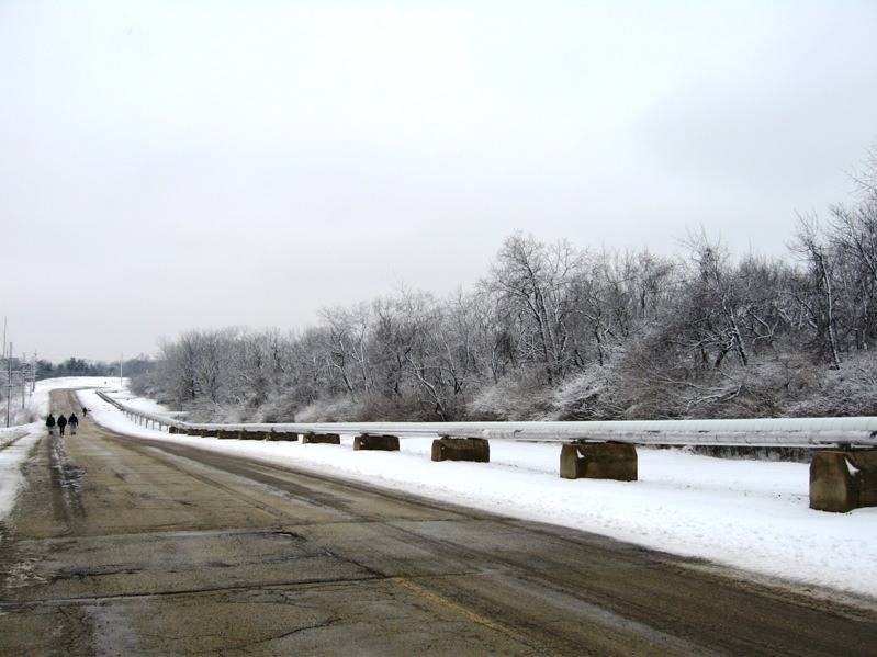

Argonne is still being heated by steam lines. Most of the buildings on the lab site do not have their own boiler. You'll see these insulated pipe lines running into many buildings from their main heating station. See the right side of the street in the photo below:
