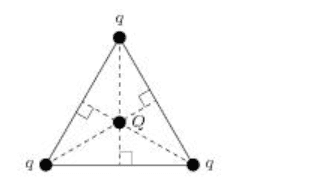

Three equal positive charges, q = 8.5 μC each, are arranged at the vertices of equilateral triangle (see figure below). A negative charge, Q, is placed at the center of the triangle such that all four charges are in equilibrium.

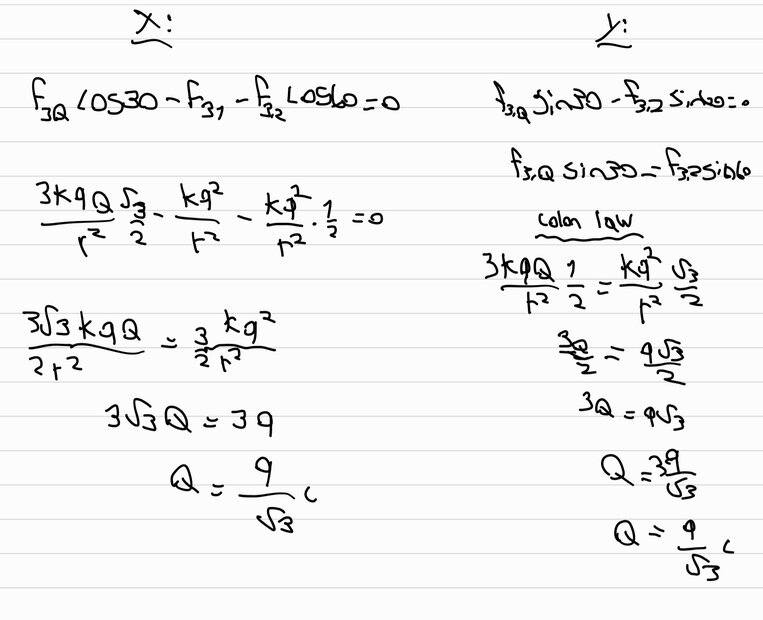

hello i would like to understand something, i found the right answer but there is still something i don't understand.
here is the figure

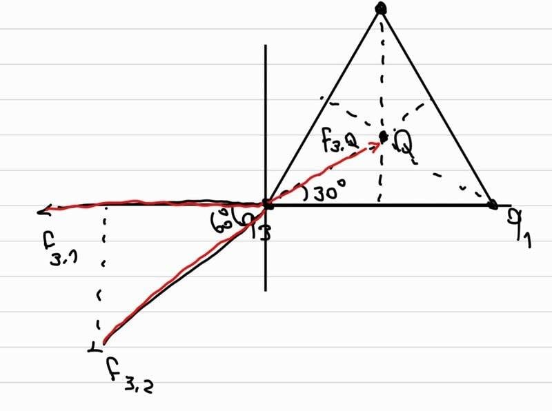

and here is my correct solution
what i don't understand is why F(3,Q) is 3kQ/r^2
i mean why is the 3? i only calculat the force between q3 and Q so why the 3 before?

What does r represent in your solution? The distance from where to where?

What is the question :smile: ? (i can guess...)
I suppose
means ##\sqrt{3}\over 2## ?
You may want to learn some ##\LaTeX## (button at lower left of edit window). Or write and draw more unambiguously (the 60##^\circ## at the lower left looks more like 45##^\circ##, smack between 30##^\circ## and 60##^\circ##...)​
You seem to think that the sides of the triangle are ##r##. Fine, but then the distance ##qQ## is not ##r## !
EDIT. Apologies @yesmale4. I misread your working. So this post is wrong and I've struck it through.
By the way @yesmale4, you have the incorrect unit in your answer. So your answer is wrong by a factor of one million!
Also, the value of q in the question is given to 2 significant figures. For consistency, your calculated value for Q should also have 2 significant figures.
I don't see a calculated value. All I see is ##Q=\dfrac{q}{\sqrt{3}}## C. The issue is that there should be no units of Coulombs in the expression since it is a relation between magnitudes of charges.

This seems rather strange. It's your solution, but you do not know where the 3 comes from.
Notice that the distance from q1 to q2 , etc. is not the same as the distance from each q to the central Q.
If you let R be the distance from each q to the charge Q in the center you should find that, ##\dfrac{r/2}{R} =\cos(30^\circ)## .
… and this is where the 3 comes from. ##\frac 1{(\frac r{\sqrt 3})^2}=\frac 3{r^2}##
