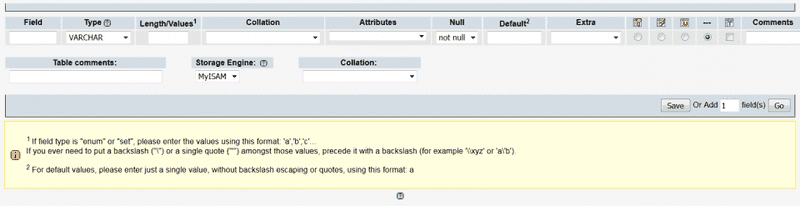

I created a database on my website, and now I'm guessing I have to add tables for the information. I have no idea what I'm looking at when I'm asked to create a table.
That's phpmyadmin, not SQL. I would ignore it, and learn how to interact with SQL directly.
Sql is like a programming language, and included in that is building commands. You can store all of this in a file and simply tell mysql to run the file.
Table is a database construct that comprises of rows and columns. Columns have properties (like name, data type etc.) and each column is a property of a particular object (e.g. a person's surname, name, address etc.). Rows are essentially collections of values of various columns. Each row holds the data of a particular object (e.g. a person or any other). So, data and by extension information, is organized in the form of various tables in a database. In your attached image you have a snapshot of phpmyadmin. You have to fill in the values for the properties of each field that your table will have.
kolleamm said:
I need a program where I can organize my data similar to excel, would MySQLWorkbench be able to do this? Can excel create sql files?
Filling in the details in phpmyadmin, you will create your table(s) and then using PHP you can insert and retrieve data from there.
Now, MySQL Workbench is a visual tool that provides data modelling, SQL development and helps in administration tasks (like server configuration for MySQL server, user administration and other useful things). It is very helpful in designing your database in an easy (visual) way.
Excel cannot create sql-type files directly. Excel files can be transferred to a MySQL database by creating a .csv (Comma Separated Values) file from your Excel spreadsheet and then importing this file into your database using phpmyadmin. Also, you can save a MySQL file as .csv through phpmyadmin and import it to Excel. You can google it for the details.
