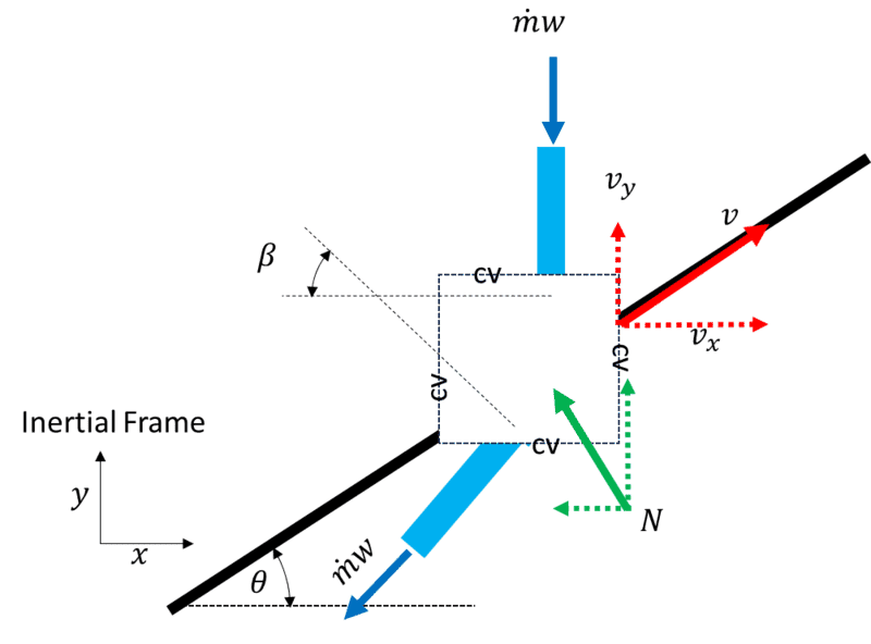

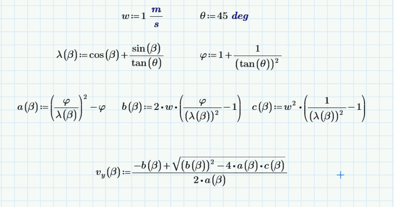

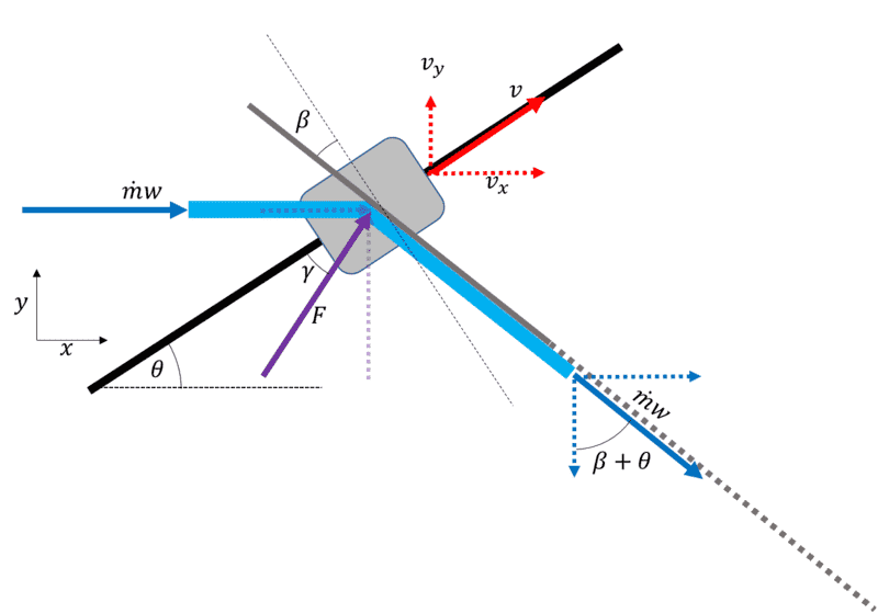

If the sail were fixed at the angle ##\beta##(making it a constant), that you say it is ( whatever it is), with the force ##F## perpendicular to the sail that implies that ## \frac{F_y}{F_x} ## or ## \frac{F_x}{F_y} ## is a constant w.r.t. to velocity.
The problem with that is:
$$ F_x = \dot m \left( w \sin ( \beta + \theta ) + v_x - w \right) $$
$$F_y = \dot m \left( v_y - w \cos ( \beta + \theta ) \right) $$
If you sub ##v_y = v_x \tan \theta## it should be apparent by inspection that isn't the case as:
$$ \frac{F_x}{F_y} = \frac{w \sin ( \beta + \theta ) + v_x - w}{ v_x \tan \theta - w \cos ( \beta + \theta ) } = f(v_x)$$
There is no one that wants it to be a constant more than I do right now, as the solution to that problem is straight forward...but its not. @A.T. already made a point of this in an earlier post.

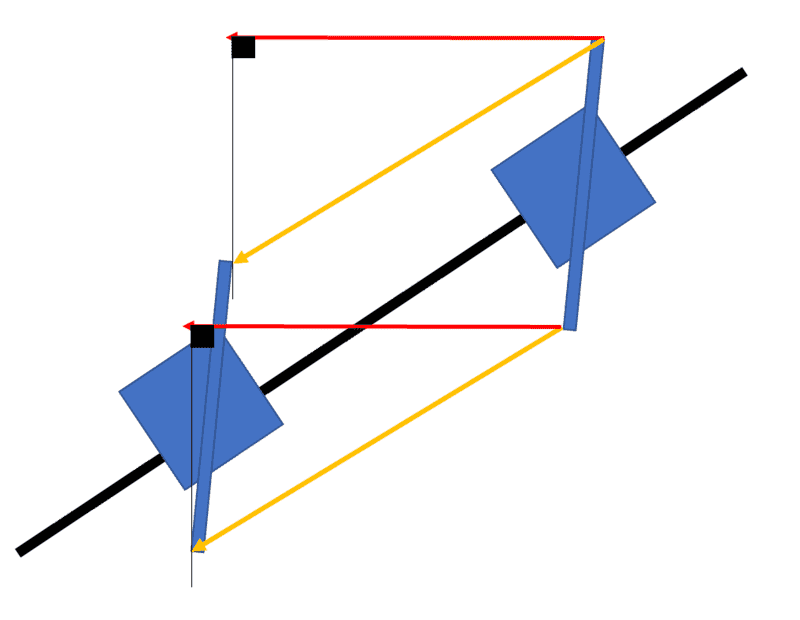

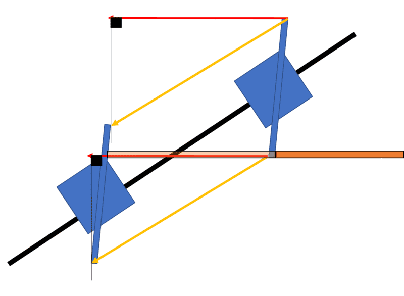

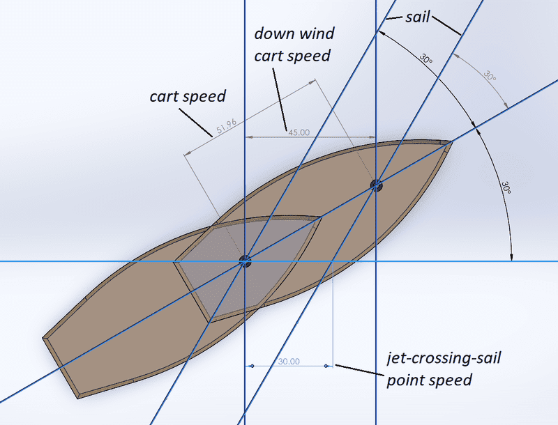

Here is illustration of sail boat diagram.
The boat is descending downwind faster than wind, but you can see, that the sail line is moving slower than wind. That makes possible for wind to make a force on the sail, which has a component (not illustrated) keeping or accelerating the boat speed.
Do you have questions to this diagram?

Its not analysis. Quit patronizing me with "vectors" that supposedly reduce everything I just went over to nothing. I am applying Newtons Laws of motion, as instructed to do so by the Fluid Mechanics textbook sitting in front me. I don't accept..."but look at randomly drawn vectors", so stop wasting your time. If you are a physicist, you should be much more inclined to hear what Newton has to say about, or figure out how what I'm saying is incorrect in an agreed upon framework of Classical Physics i.e. Newtonian Mechanics and tell me about it.
Your flow analysis suppose to come to the same. What way do you defining the outgoing flow?

Look at the diagram. It shows everything I have planned.
This equation represents Newtons Second in Fluid Mechanics under the assumption of constant cross-sectional properties:
$$ \sum F = \frac{d}{dt} \int_{cv} \rho v ~d V\llap{-} + \sum_{cs} \dot m_o v_o - \sum_{cs} \dot m_i v_i $$

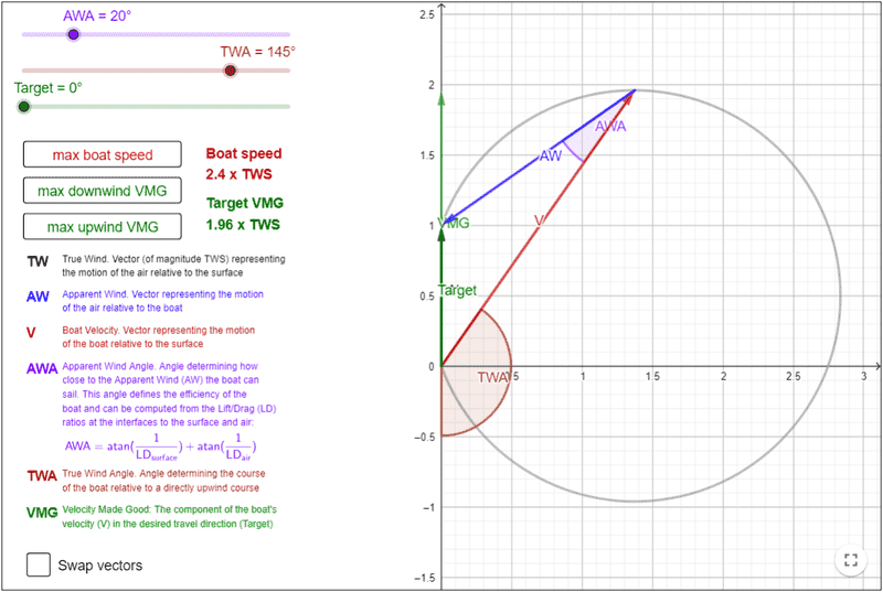

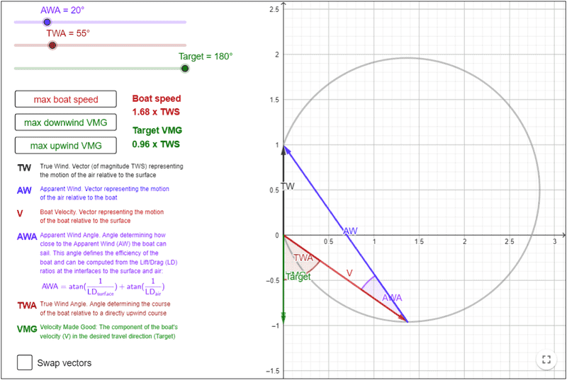

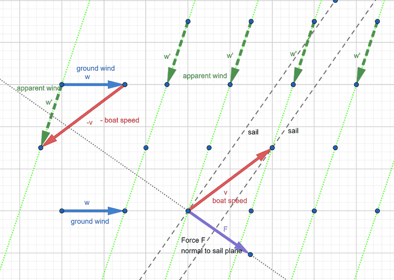

Here is a paper by a physics professor in a physics journal, analyzing the same thing and using vectors of course:
High-speed sailing, Wolfgang Püschl 2018 Eur. J. Phys. 39 044002
https://iopscience.iop.org/article/10.1088/1361-6404/aab982

The sail has no orientation in that diagram. Its orientation relative to the cart is characterized by the parameter ##\beta## which I hope to first optimize as a function of ##v_x##. I.e the expectation is that there is a little man on the boat that is turning the sail to maximize the component of the applied force ##F## in the direction of motion over the entire duration of the analysis.
OK, but note that:
- the example ##\beta## you have drawn is wrong for maximizing ##v##. See post #142.
- you have drawn the relative outgoing flow again, because it is parallel to the sail. This is not how the outgoing flow looks like in the ground frame where the sail is moving.
But your diagram doesn't have ##\dot m_o v_o## in it. The outgoing flow is labeled ##\dot m w##, which is of course wrong, because the flowspeed ##w## (in the ground frame) will change after the interaction with the sail.
So how do you plan to determine that ##v_o## for all possible speeds of the boat?

The subscripts ##i,o## refer to inflow, outflow respectively. The problem here, given this statement and the fact that I have done this analysis 5 times over with this notation in this thread means that you haven't actually tried to digest any of it until just now.

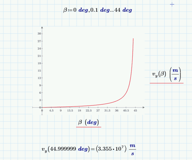

I said ##\beta## is a parameter I was proposing to optimize as a function of ##v_x##, to maximize ##F \cos \gamma##.
This is not a diagram of the flow throughout all time and space. It is a snapshot capturing the momentum change of the impinging jet immediately before and after impacting the sail at some specific time, location on the infinite planar sail.

No, I'm telling you to look at vectors, which are consistent with real world lift/drag-data for airfoils. This removes the whole messy fluid dynamics from the problem. Even for a numerical approach you can use empirical lift/drag-data, instead of CFD.

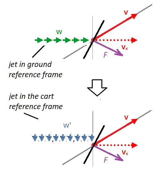

I was keeping fluid mechanics of lift generation out of it. There is no lift generated on the vane. It is not an airfoil.
Lift is the force component perpendicular to the relative flow. Your vane will certainly produce some lift, at most angles of attack (all except +/- 90°). Even a brick can produce some lift. But key to performance is the ratio of lift to drag, which determines the angle between relative flow and aerodynamic force. The rest follows from those angles.
There is no flow over the vane. There is a force from the impulse of the jet changing it’s momentum. Is that what you are calling lift, because that’s not what I would call it. My analysis is happening in a vacuum. There is no lift, there is no drag….
