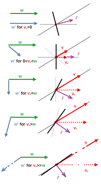

Yes, that would work better for downwind travel at ## v_x = w ##.
erobz said:
Is the flow coming in tangentially or horizontally?
The 2D vector math is:
flow_relative_to_vane = flow_relative_to_ground - vane_velocity_relative_to_ground
If you want the incoming flow_relative_to_vane to be exactly tangential to the vane, then you to have adjust the vane orientation for every vane_velocity_relative_to_ground.
But for ## v_x = w ## the above configuration would have tangential relative incoming flow along negative y.

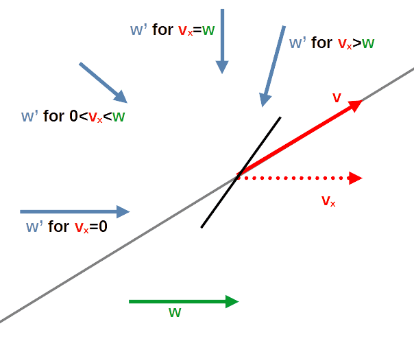

Yes, this is the relative flow at ## v_x = w ##, and the force on the vane has now a component in the positive direction of ## v ## so it can still accelerate.
  • #101
A.T. said:
Yes, this is the relative flow at ## v_x = w ##, and the force on the vane has now a component in the positive direction of ## v ## so it will still accelerate.

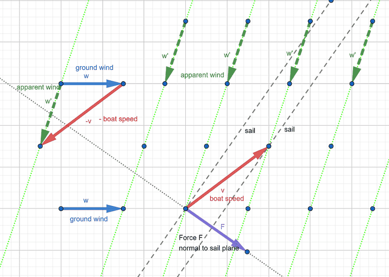

The limit for ##v## is fully determined by the maximal lift/drag ratio of the vane and ##\theta## (because the track is frictionless). More generally it depends on both lift/drag ratios: at the air and at the surface.
This is explained here:
https://www.onemetre.net//design/CourseTheorem/CourseTheorem.htm
And visualized here (see also references in the description):
https://www.geogebra.org/m/tj5qf3w2
In short the lift/drag ratios determine the apparent wind angle AWA (usually called ##\beta##).
AWA = atan(1 / LDsurface) + atan(1 / LDair)
This AWA-angle then determines the size of the polar circle, that limits the speed for any given course (true wind is to north and the scale is true wind multiples):
The above example assumes AWA = 6°, which is based on GPS measurements with iceboats:
https://www.nalsa.org/Articles/Cetus/Iceboat Sailing Performance-Cetus.pdf
This allows a downwind velocity component of more than 5 times true windspeed.

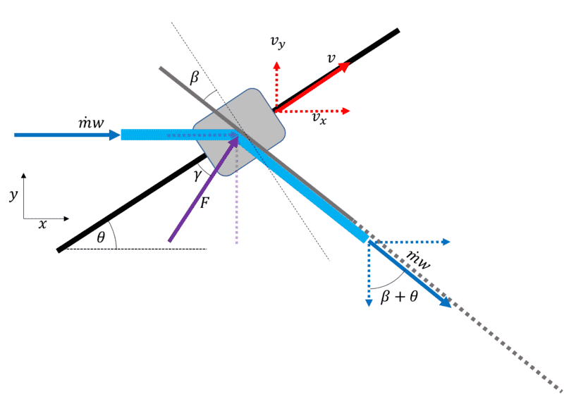

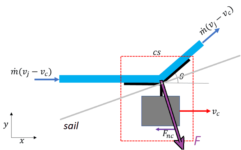

I get the following system of equations:
##y## direction
$$ N \cos \theta = M \frac{dv_y}{dt} + \dot m v_y - \dot m w \cos \beta + \dot m w \tag{1} $$
##x## direction
$$ -N \sin \theta = M \frac{dv_x}{dt} + \dot m v_x - \dot m w \sin \beta \tag{2}$$
Using the constraint and it derivative:
$$\frac{v_y}{v_x} = \tan \theta \tag{3} $$
$$ \implies \frac{dv_y}{dt} = \frac{dv_x}{dt} \tan \theta \tag{4} $$
The final ( sub 2 ##\to## 1, then 3,4, ##\to## 1 ) resulting ODE for ##x## direction:
$$ M \frac{dv_x}{dt} ( 1 + \tan^2 \theta ) + \dot m v_x ( 1 + \tan^2 \theta ) + \dot m w ( \tan \theta - \cos \beta \tan \theta - \sin \beta) = 0 \tag{5}$$
From which the steady state response is given by:
$$\lim_{\dot{v}_x \to 0 }(5) \implies v_x \to -w\frac{( \tan \theta - \cos \beta \tan \theta - \sin \beta)}{( 1 + \tan^2 \theta )}$$
My position is that this result does not support the claim that ##v_x## can exceed ##w##.
You should do some reality-checks with simple cases, like the one shown in your current diagram (## v_x = w ##). It's easy to see what the direction of force F on the vane would be, given the flow deflection. And since F has a component in the direction of v, the cart will accelerate further.

So, I think the objective is to maximize the component of velocity ##v_x## of the cart by maximizing the force ##F_x##. A maximal ##v_x## maximizes ##v_y## by constraint (3) in post #103.
To achieve this, I introduce the parameter ##\varphi## for the angle of rotation of the vane relative to the cart. The intention is to find ##\varphi## as a function of ##v_x## that maximizes ##F_x## for a fixed angle of turn ##\beta##.
From the diagram above we find that:
$$ F_x = \dot m \left( v_x - w \sin( \beta + \varphi )\right) \tag{1}$$
Next, attempt to optimize ##F_x## w.r.t. ##v_x##
$$ \frac{dF_x}{dv_x} = \frac{ d \dot m }{d v_x} \left( v_x - w \sin( \beta + \varphi ) \right) + \dot m \left( 1 - w \cos ( \beta + \varphi ) \frac{ d \varphi}{d v_x} \right) \tag{2}$$
Under continuity the mass flowrate entering-exiting the control volume is given by:
$$ \dot m = \rho A ( w + v_y ) = \rho A ( w + v_x \tan \theta ) \tag{3}$$
This implies that:
$$ \frac{ d \dot m }{d v_x} = \rho A \tan \theta = constant. \tag{4} $$
Making the substitutions ##(3)## and ##(4) \to (2)## becomes:
$$ \frac{dF_x}{dv_x} = \rho A \tan \theta \left( v_x - w \sin( \beta + \varphi ) \right) + \rho A ( w + v_x \tan \theta ) \left( 1 - w \cos ( \beta + \varphi ) \frac{ d \varphi}{d v_x} \right) \tag{2'}$$
Optimization implies looking for the solution to:
$$ 0 = \frac{dF_x}{dv_x} = \rho A \tan \theta \left( v_x - w \sin( \beta + \varphi ) \right) + \rho A ( w + v_x \tan \theta ) \left( 1 - w \cos ( \beta + \varphi ) \frac{ d \varphi}{d v_x} \right) \tag{5}$$
Solving (5) for ## \varphi '## yields the following first order nonlinear ODE:
$$ \frac{ d \varphi }{ d v_x} = \frac{w - w \tan \theta \sin ( \beta + \varphi)+ 2 \tan \theta v_x}{ \cos ( \beta + \varphi ) \left( w^2 +w v_x \tan \theta \right) } \tag{6}$$
How am I doing so far?
  • #119
No, as already said:
A.T. said:
....the optimal vane orientation for each speed: The one that maximizes the component of F in the positive direction of v.
Also shown by the dotted blue arrow:
  • #120
Maximizing ##v_x## maximizes ##v##. The motion is constrained by ##v_y = v_x \tan \theta##
