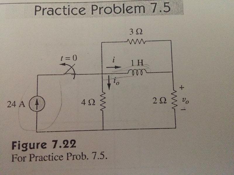

Current direction after changing inductor to short circuit
Abdulwahab Hajar
56
In the figure in the picture uploaded assume that the switch has been closed for a long time such that the inductor acts like a short circuit. Through which resistors does the current pass through and why??
A short circuit is basically a wire or a zero resistance, and as we know current passes through the path with least resistance.
I know what the solution but I don't understand why, it says the current won't pass through the 3Ω resistor... Is it because no potential difference is across it meaning that the current would be zero??

  • Circuit schematic labelled Figure 7.22 with a 24 A current source on the left, a switch marked t=0, a 3 ohm resistor on top, a 1 H inductor carrying current i, a 4 ohm resistor carrying current io, and a 2 ohm resistor with voltage vo across it.
Yes.
