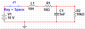

I am trying to figure out how to calculate the time at which current will peak in the following circuit.
Seems to me the capacitor will have no effect and the circuit will become a basic LR circuit in which the time constant is: 10/10010=.00099 x 5 = 4.9mS. Is this correct?
Any help will be greatly appreciated.

Write the differential equation for the current, and solve it with the boundary condition of the switch closing at t=0.
If we use Laplace transform we can write the Laplace impedance of the capacity ZC=1/(s*C1) and R2 will be
Z12=ZC*R2/(ZC+R2)=R2/(s*C1)/(1/(s*C1)+R2)=R2/(1+R2*C1*s)
Then the i(s)=V1/s/[L1*s+R1+R2/(1+R2*C1*s)]
i(s)=V1*(1+R2*C1*s)/[ R2*C1*L1*s^3+(L1+R1*R2*C1)*s^2+(R1+R2)*s]
If R2*C1*L1*s^3+(L1+R1*R2*C1)*s^2+(R1+R2)*s=0 we get s3=0;s1,s2
Let’s put :
a= R2*C1*L1 ; b= (L1+R1*R2*C1); c=R1+R2
a=10000*5/10^9*10=0.0005; b=(10+10*10000*5/10^7)= 10.05; c=10+10000=10010.
Then a*s^2+b*s+c=0
s1=[-b+sqrt(b^2-4*a*c)]/(2*a) s2=[-b-sqrt(b^2-4*a*c)]/(2*a)
s1= -1056.787 ; s2= -18944.21
i(s)=V1*(1+R2*C1*s)/[a*(s-s1)*(s-s2)*s]=U(s)/[s*W(s)]
U(s)=V1*(1+R2*C1*s)/a ;
W(s)=(s-s2)*(s-s1)=s^2-(s1+s2)*s+s1*s2
W’(s)=2*s-(s1+s2)
Transforming in i(t):
i(t)=U(0)/W(0)+U(s1)/W’(s1)/s1*exp(s1*t)+ U(s2)/W’(s2)/s2*exp(s2*t)
Substituting s1 and s2 we get:
U(0)=V1/a =10/.0005 = 20000 ; W(0)=s1*s2= 20020000
U(s1)= 18943.21 ; U(s2)= 1055.787 ;W’(s1)= s1-s2 ; W’(s2)= s2-s1
The maximum it is t for di(t)/dt=0
di(t)/dt= U(s1)/W’(s1) *exp(s1*t)+ U(s2)/W’(s2) *exp(s2*t)=0
exp((s1-s2)*t)= U(s2)/W’(s2)*W’(s1)/U(s2)
tmax=ln(U(s1)/U(s2))/(s1-s2)=ln(18943.21 /1055.787)/( -1056.787 -( -18944.21))
tmax= 0.000161 sec

Sorry, I did not remark berkeman’s answer. It could be simpler, I guess.
i=total current; i1=capacitor current ; i2 = current through R2
V1=L1*di/dt+R1*i +R2*i2 first circuit
R2*di2/dt=-(L1*d2i/dt2+R1*di/dt)
integral(i1/C1*dt)=R2*i2 second circuit
i1/C1=R2*di2/dt ; i1=C1*R2*di2/dt; i1=-C1*(L1*d2i/dt2+R1*di/dt)
i=i1+ i2 i2=i-i1
i2=i+C1* (L1*d2i/dt2+R1*di/dt) then:
V1=L1*di/dt+R1*i +R2*[ i+C1* (L1*d2i/dt2+R1*di/dt) ] or:
R2*C1*L1*d2i/dt+(L1+R2*C1*R1)*di/dt+(R1+R2)*i=V1
a=R2*C1*L1 ; b=(L1+R2*C1*R1) ; c=(R1+R2)
ax^2+bx+c=0
x1=[-b+sqrt(b^2-4*a*c)]/(2*a)
x2=[-b-sqrt(b^2-4*a*c)]/(2*a)
x1= -1056.787 ; x2= -18944.21
i(t)=A*exp(x1*t)+B*exp(x2*t)+C
Since both x1 and x2 < 0 then for t=infinite C=V1/(R1+R2)
d2(i(t))/dt=x1^2*A*exp(x1*t)+x2^2*B* exp(x2*t)
If i(0)=0 then A+B+C=0 A+B=-C
If i(0)=0 then i2(0)=0 [at t=0]
Then C1* (L1*d2i/dt2+R1*di/dt) =0
di/dt= x1*A*exp(x1*t)+x2*B*exp(x2*t)
d2i/dt2= x1^2*A*exp(x1*t)+x2^2*B*exp(x2*t) and
L1*d2i/dt2+R1*di/dt= L1*[A*x1^2+B*x2^2]+R1*[A*x1+B*x2]=0 or:
A*[L1*x1^2+R1*x1]+B*[L1*x2^2+R1*x2]=0 B/A=- (L1*x1^2+R1*x1)/( L1*x2^2+R1*x2)
B/A= -0.003109093
In order to find the maximum :
di/dt= x1*A*exp(x1*t)+x2*B*exp(x2*t)=0
x1*A*exp(x1*t)=-x2*B*exp(x2*t) -B/A=x1/x2*[exp(x2-x1)*t]
[exp(x2-x1)*t]=-B/A*x2/x1
tmax=ln(-x2/x1*B/A)/(x2-x1)=ln(18944.21/1056.787* 0.003109093) /( (18944.21-1056.787)= 0.000161 sec.
