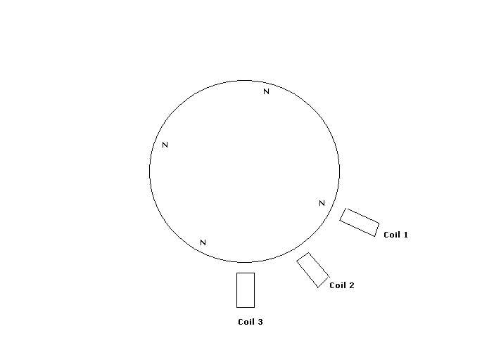

Hello Forum,
I have a 3 phases DC brushless motor from a Hard Disk Drive, when energize one coil and turning by hand the rotor i can feel 4 steps per rotation, is this means that this motor has 4 poles of north and south?
Thank you in advance,
Anita
I saw a similar motor in a hard drive.
I couldn't open it but I think it was as in the attached diagram.
If you activated coil 3 it would attract the N pole to the left of it and the disk would rotate counterclockwise. Then activate coil 2 then coil 1. Then activate coil 3 again to attract the next North pole.
I made a switching circuit for it and got it rotating but it was a bit jerky at slow speeds.
Maybe your motor is similar.

There are two basic types of BLDC (brushless dc motors). One type has a HALL EFFECT sensor that can be used for commutating the dc voltages. The other type uses the induced back emf to commutate the dc voltages. How many wires/terminals come out (not counting ground)? Do you think the coil inputs are wired as a delta or wye (use resistance meas)?

hello , it has 3 wires and one common , it's a brushless DC motor Y connected. the questions is how i can know the number of poles ? in this way i can know : when energize one coil and turning by hand the rotor i can feel 4 steps per rotation, is this means that this motor has 2 poles of north and 2 poles of south?

I think mine also had 4 poles and they would be permanent magnets with all their south poles all facing inwards and unused but the north poles facing outwards and being attracted to the 3 coils as they were turned on in order.
It had some screws holding it together but I didn't have anything that would fit the head of the screws to take the mechanism apart.
It seemed to work as in the above diagram, but I wasn't too sure about it. It worked if I fed it like that, so I guess it was close enough. Yet, I am surprised they would have strong magnets so close to the hard drive data.
