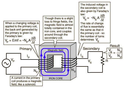

I recently learned that if you send direct current through the primary coil of a transformer, no power would be transferred to the secondary circuit? Why is that?
Can you tell us why it works for AC? If so, then you should know why it does not work for DC.
Theoretically, it would work. Since the flux in the core of the transformer increases by the integral of the applied voltage (Faraday's law), in an ideal transformer, the flux would just continue to increase. However, if you tried this with an actual transformer, you would drive the core into saturation and create a lot of heat.

A changing current produces a changing magnetic field, which in turn can induce a current in the secondary. If the current is not changing, the magnetic field is not changing, so no current is induced in the secondary.
When you first apply a DC voltage the current ramps up, so the field is changing and an initial current is induced in the secondary. But when the current stops changing (limited by resistance, for example) there will be no current induced into the secondary.

Referring to the picture, if most of the magnetic flux stays inside the iron core, how do moving field lines cut through the secondary coil?
The field lines do not have to be moving. The changing magnitude and direction (+/-) of the primary current generates a changing flux value, which in turn induces the changing secondary output voltage.
If the flux value (concentration of field lines) changes, do the magnetic field lines move?
It's a quirk of the universe that the "lines" need not "cut" the conductors,
only that they be encircled by the conductors.
See https://en.wikipedia.org/wiki/Faraday's_law_of_induction and http://hyperphysics.phy-astr.gsu.edu/hbase/electric/farlaw.html
The field itself is more of a continuous fluid than discrete lines. It goes everywhere , just changes its intensity as you get farther from its source.
But drawing lines helps us visualize it and gives us something we can count to gauge its intensity.
A "line" is a called Maxwell, one of them per square centimeter is called a Gauss which is roughly the magnetic field strength of Earth that tugs your compass needle around.
A field strength of ten thousand Gauss is called a Tesla, about the field strength of a good loudspeaker magnet.
