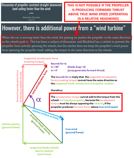

UPDATE: Prof. Alexander Kusenko (UCLA) thinks DDFTTW is impossible and has a 10000$ bet with Derek Mueller (Veritasium):

In the latest version of his slides Prof. Kusenko, has presented his theory of why the DDWFTTW models are advancing against a treadmill belt (even against a slope):
It seems to be based on that single video, and ignoring other similar tests. But even in that specific clip, the cart advances from the very rear of the treadmill (0:43-0:45), so it would be climbing that potential energy hill, he envisions in his slide:

It looks like Prof. Kusenko has conceded the wager:
After admitting to being wrong about DDWFTTW being possible, Prof. Kusenko still thinks he has a better understanding of how it actually works, than the people who build the Blackbird, or those who published previous analyses correctly predicting its behavior. Here is Prof. Kusenko's explanation:
https://docs.google.com/presentatio...KDkhEfN898K4/edit#slide=id.gb6e540a45a_618_51
Alexander Kusenko said:
When the car is moving faster than the wind, the passing air pushes the propeller in the same direction as the wheels push it. This has been a subject of discussion, and Blackbird has a ratchet to prevent the propeller from actively spinning the wheels, but the ratchet does not keep the propeller’s wind power from spinning the propeller itself, adding the torque in the same direction as the wheels.
Here is why I think Prof. Kusenko's alternative explanation is wrong:

jbriggs444 said:
Amazing how much blithering one can do talking about a turbine when the relevant mechanism is a propeller.
Yes Kusenko talks a lot of nonsense, but to be clear when traveling DDWFTTW the thing that looks like a propeller is not acting as a propeller, it is acting as a turbine: extracting kinetic energy from a fluid and using it to drive the wheels.
I believe that you have that backward.
In a downwind configuration, the relative headwind is passing slowly and the ground is passing rapidly. You win by using a propeller to gain high thrust from the wind with a low power requirement while the wheels provide high power from the ground at an expense of low drag.
In an upwind configuration, the relative headwind is passing more rapidly then the ground. You win by using a turbine to gain power and the wheels to provide thrust.
The gearing is different for the two configurations and I believe that the blade shape is as well.
Additionally to the explanation by @jbriggs444 why this wouldn't work, consider this: A turbine moving DDWFTTW would push the air forward (in the downwind direction), thus creating more true wind, instead of extracting wind energy form it.
