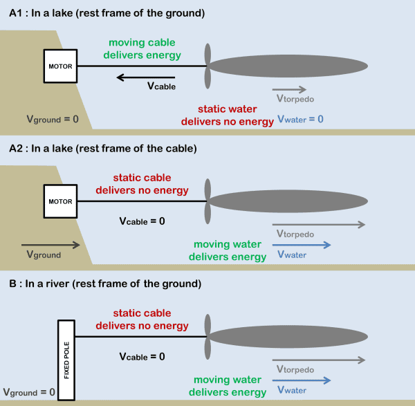

Here is an animation that explains how the coupling to the wheels forces each section of the propeller blade to move across the wind:
Just like the keel forces the sail to move across the wind when downwind velocity component > windspeed:
I posted the vectors for both situations here:
https://www.physicsforums.com/threa...ast-confusing-explanation.896869/post-6499006
