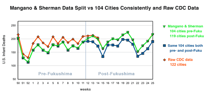

Last Monday a press release announced the shocking result of a new study:
Medical[/PLAIN] Journal Article: 14,000 U.S. Deaths Tied to Fukushima Reactor Disaster Fallout
Immediately seeing major problems with that study by Mangano & Sherman (M&S), I asked a statistician what he thought of it. He crunched the data and while he found several devastating statistical problems, his most remarkable finding was that the U.S. infant-death data M&S report as being from the CDC does not jibe with the actual CDC infant-death data for the same weeks.
The M&S infant-death data allegedly from the CDC can be http://www.radiation.org/reading/pubs/HS42_1F.pdf (go to Table 3, page 55). And the actual CDC infant-death data can be seen here (go to Locations, scroll down and select Total and press Submit for the data; the data for infants is in the Age column entitled "Less than 1"). The mismatching data sets are included at the end of this post, and with the links I've provided here, everything I'm saying can be independently confirmed by the reader.
Here are the mismatching data sets, note that post-Fuku weeks 15 through 24 do match:
2010 (weeks 50-52) 2011 (weeks 1-25)
wk http://www.radiation.org/reading/pubs/HS42_1F.pdf CDC
50 : 202 216
51 : 129 143
52 : 113 130
1 : 158 183
2 : 177 208
3 : 158 185
4 : 148 171
5 : 178 208
6 : 173 182
7 : 188 206
8 : 158 186
9 : 174 199
10 : 165 182
11 : 188 209
12 : 201 211
13 : 210 213
14 : 198 204
15 : 163 163
16 : 188 188
17 : 200 200
18 : 196 196
19 : 214 214
20 : 224 224
21 : 196 196
22 : 152 152
23 : 174 174
24 : 191 191
25 : 215 217
The nature of the mismatch is that all the pre-Fukushima M&S data points are lower than the actual CDC data points and bias the data set to to a statistically significant increase in post-Fukushima infant deaths. But in the actual CDC data, there is no statistically significant increase. The statistician also found that even M&S's data for all-age deaths was in fact not statistically significant, contrary to the claim of M&S.
Why the infant data are mismatched is not understood at this time. However, a review of the archived copies of the Morbidity and Mortality Weekly Report archive finds that the historically released data points for the weeks in question jibe with the CDC's MMWR database. So I see no reason to believe the CDC's online data are not the true data.

This explains their data manipulation that resulted in the mismatch above. From page 52 of http://www.radiation.org/reading/pubs/HS42_1F.pdf (bold emphasizes the manipulation):
The 2010–2011 comparison of deaths in weeks 12 to 25 included 119 of
the 122 cities
in the CDC report. Excluded were Fort Worth, Texas; New
Orleans, Louisiana; and Phoenix, Arizona; for these cities, deaths in more
than half of the weeks were reported as “unavailable.” The completeness of
reporting for both periods exceeded 99 percent. For the earlier 14-week periods,
only 104 of the 122 cities
that reported death figures more than 99 percent of
the time were included. For the cities and weeks excluded from the analysis,
see Appendix Table 3.
So Mangano & Sherman's pre-Fuku data (weeks 50 - 11) only included 104 cities (of the 122 cities in the CDC database), but for the post-Fuku data (weeks 12 - 25) they included 119 cities. The exclusion of cities from the pre-Fuku data resulted in a lowering of total-death counts that thereby produced a statistically significant post-Fuku increase in deaths. The statistician I'm communicating with eliminated the same cities from the post-Fuku data so that the number of cities remains constant at 104 across the data set, and then the statistical significance disappears.
A crystal clear example of massaging the data until it fits your thesis -- pathetic!

Mangano & Sherman 2011 said:
The 2010–2011 comparison of deaths in weeks 12 to 25 included 119 of the 122 cities in the CDC report. Excluded were Fort Worth, Texas; New Orleans, Louisiana; and Phoenix, Arizona; for these cities, deaths in more than half of the weeks were reported as “unavailable.” The completeness of reporting for both periods exceeded 99 percent. For the earlier 14-week periods, only 104 of the 122 cities that reported death figures more than 99 percent of the time were included. For the cities and weeks excluded from the analysis, see Appendix Table 3.
A statistically significant increase only exists for the http://www.radiation.org/reading/pubs/HS42_1F.pdf green-line.

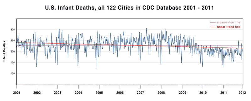

SpunkyMonkey said:
From that graph, it looks like a short-term deviation of 50 or even 100 is just noise.
There is something significant there. What happened in 2008 or 2009?
Are these figures actually deaths per some number of births, or does birth rate need to be taken into account here?
I would be interested in seeing the parents' background (income, employment). I was thinking about the possibility of a correlation between economic troubles and infant deaths.
Right, the decline after '08 is statistically significant. But I have no idea sup with that. ??!
And contrary to what the graph seems to want to imply, there doesn't seem to be a long-term decline evident in the data. I don't know why they would put that linear fit.
Mangano & Sherman only analyzed infant deaths, not infant mortality. And so the data I've posted are also only infant deaths. Not using infant-mortality data is just another entry in the long list of flaws in their argument. Reason being, any increase in infant deaths could simply reflect an increase in live births.
The data are for deaths in 122 entire cities all across the U.S., so there's probably not too much reason to anticipate a selection bias. But yeah, such an economic effect might still work it's way into the data, and the middle class has been hit hard too. The decline after '08 might reflect fewer planned births due to the costs of child rearing.
