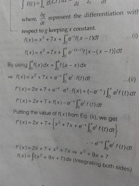

The question says:
f (x)=x2+7x +∫0x(e-tf (x-t)dt.
Find f (x).
None
What I did is:
Consider the integral:
I=∫0x (e-tf (x-t)dt
We know that ∫abf (x)dx=∫abf (a+b-x)dc
So using it here:
1/ex0xetf (t)dt----(1)
Leaving the "1/ex part for now.
From the original equation f (t)=t2+7t +∫0te-t f (0)dt
And we can see that f (0)=0
So f (t)=t2+7t
Using (1) without 1/ex...
0xet(t2+7t)dt
Which can be calculated to ex(x2+5x -5)
Which is when divided by ex becomes
x2+5x-5=I
Now adding I to the original equation of f (x)..
Thus f (x)= 2x2+12x -5x.
But in the solution they have done something else. So what is wrong with my solution to this question?

You are scrambling ##x## and ##t## up left and right. I don't see how you can conclude ##f(t)=t^2+7t## and then go on to derive that ##f(x)=2x^2+12x-5##. Does that even make any sense?? I think you should look back and figure out where you went wrong yourself. There are really too many places to mention.

Thanks...
And now I understand why I can't put ##t ## in ## f (x) ##. So what I understand now is that this method is useful for nothing. I had one problem in my mind...
If I differentiate ## f (x) ## using the Leibnitz rule, then I'll get:
## f'(x) = 2x+7+e^{-x}f (x-x)##
And since ##f (0)=0 ##{is it true? }
Therefore $$f'(x)=2x+7$$
And if we integrate it (sounds like I am again jumping back and forth):
##f (x)=x^2+7x +C##
So does that mean that the integral in the original equation is a constant?

The first mistake is the bold part. You cannot treat 1/ex as constant.

In the equation ##f(x) = x^2 + 7x + \int_0^x e^{-t} f(x-t) \, dt##, what do you get by taking ##x \to 0##?
Anyway, using a Laplace-transform approach I get a solution quite different from your supposed solution ##f(x) = x^2 + 7x + C##.

The poster in #5 has mis-used Leibniz rule.
$$ \frac{d}{dx} \int_0^x e^{-t} f(x-t) \, dt = e^{-x} f(0) \; \Leftarrow \; \text{wrong!} \\
\frac{d}{dx} \int_0^x e^{-t} f(x-t) \, dt = e^{-x} f(0) + \int_0^x e^{-t} f'(x-t) \, dt \; \Leftarrow \; \text{correct}
You can see right away that the function ##f(x) = x^2 + 7x## does NOT solve the equation
$$ f (x)=x^2+7x + \int_0^x e^{-t} f(x-t) \, dt, $$
because that would require that ##f(x) = f(x) + \int_0^x e^{-t} f(x-t) \, dt,## so would require that we have ##\int_0^x e^{-t} f(x-t) \, dt = 0 ## for all ##x##---which is false.

No the leibniz integral rule is:-
$$\frac{\partial}{\partial x}\int_{a(x)}^{b(x)}f(x,t)\ dt=\int_{a(x)}^{b(x)}\frac{\partial f}{\partial x}\ dt+f(b(x),x)\frac{\partial b}{\partial x}-f(a(x),x)\frac{\partial a}{\partial x}$$
