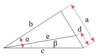

In the chapter about differentiation there is this question:
Cosine rule:
$$a^2=b^2+c^2-2bc\cos\alpha$$
$$\cos(\alpha-\beta)=\cos\alpha\cos\beta+\sin\alpha\sin\beta$$
$$d^2=e^2+c^2-2ec\cos\beta$$
$$(a-d)^2=b^2+e^2-2bc\cos(\alpha-\beta)$$
It doesn't lead to the solution

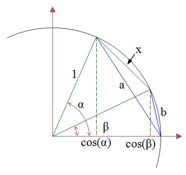

I wouldn't set it up the way you have in your drawing. Sketch the unit circle with one ray making an angle of ##\alpha## going out to the point ##(\cos \alpha, \sin \alpha)## on the unit circle. Draw another ray with a smaller angle of ##\beta## going out to the point ##(\cos \beta, \sin \beta)## on the unit circle.
Use the Law of Cosines to find the distance between those two points on the unit circle. The result for ##\cos(\alpha - \beta)## is pretty easy after that.
$$a^2=2(1-\cos\alpha),~~b^2=2(1-\cos\beta)$$
$$x^2=2(1-\cos(\alpha-\beta))$$
$$x\neq a-b$$
Even if x were (a-b) it's complicated
$$x\neq a-b$$
But you can compute what x is, because you know where the line segment x starts and ends. You only need pythagoras to do that.
Then you use the law of cosines to find Cos(A-B) from x.
$$x^2=(\sin\alpha-\sin\beta)^2+(\cos\beta-\cos\alpha)^2=2-2\cos(\alpha-\beta)$$
$$\Rightarrow\cos(\alpha-\beta)=\sin\alpha\cdot\sin\beta+\cos\alpha\cdot \cos\beta$$
