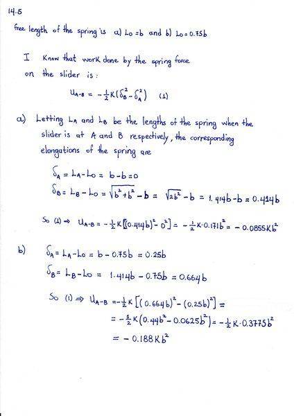

Derive the expression for the work done by the ideal spring
1 reply · 3K views · last reply
Alexanddros81
177
Derive the expression for the work done by the ideal spring on the slider when the
slider moves from A to B. Assume that the free length of the spring is (a) ##L_0 = b##;
and (b) ##L_0 = 0.75b##
Can you check if my solution is correct?
