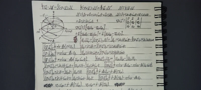

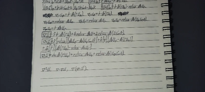

I'm trying to derive the various spatial derivatives, and find that I'm missing pieces. I'd like another set of eyes please.
div, grad, curl, grad^2
See photo. First, I see that I get more standard results by crossing theta before phi. What's the importance of that? Also I'd get more standard results by allowing some r or sine factors to leave their derivative enclosures and unify.

Your images are very difficult to read, due to how small the images appear. This is one of the reasons that we recommend against posting hand-written images of work.

I actually figured out at least part of my answer. I was ignoring the space made by r x theta = phi, or more specifically i was working in the incorrect space r x phi = theta, which is why some of my components are the negative of the accepted answers. I figured this out by looking at my drawing, where on the upper left of my sphere the r meets the r theta and the r phi sin theta.
There's my second question tho. I derived the gradient by comparing to the results of the cross, assuming the del operator there is the gradient. But mine contain variables within the partials. I wonder if the accepted answers allow those to be factored out because they're unrelated to the associated scalae function's component

Which is still illegible.

He's referring to the images you posted.

I know. But I did describe the problem I was having. I didn't realize how low-res rhe images would come out. Initially I posted the entire page, and then I divided it in 2 like this. My work is kinda legible enough if you know what you're looking for

But that doesn't help much if we can't see the work.

That's a pretty subjective assessment. So far, two people say no vs. one who says yes.

And the one knows what it says anyway, which helps.
ok, I'll just describe what I did. First I drew a sphere and arrows representing the basis vectors: r, r theta, r phi sin theta. Where they meet, r x theta = phi. I see that maintaining that implicit order for the determinant of the curl results in the correct results for the curl: {r, theta, phi}.
I defined unit vector path and vector area, dl and da, and I note that (1/3) dl dot da = dV, the unit volume. I undid two vector integrals to create both the divergence and the curl: for vector function U, its closed integral dot da = integral divergence U dV; and also closed integral curl U dot da = closed integrals U dot dl.
For the curl, I wrote out the results of the determinant of column vectors (r, del r, U r), (theta, del theta, U theta), and so for phi. Then I followed a similar procedure as the divergence, undoing the integrals by direct comparison.
For the gradient, I assumed the dels within the column vectors of the curl were gradients. I listed the results of the curl, and then took the most general form of each del operator as the gradient.

That really does not help much by itself. Please take the trouble to post the working as well, typing the equations in, preferably using LaTeX.
