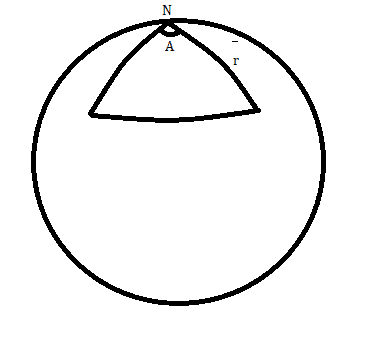

Yes I realized that after some time later. First I thought that from the metric we can define a general area equation for any spherical triangle. However as you mentioned that's possible.. Let's suppose we have a triangle like this. N is the north pole and it makes an angle of A. From the metric I find that the angle can be expressed as
$$Area = \int_0^A \int_0^r Rsin(r/R)drd\theta$$
Your triangle is not well defined, you need to specify three numbers to completely specify the triangle.
Well yes sorry the other length is also r. So the bottom length becomes ##ARsin(r/R)dr## (from ##ds = Rsin(r/R)d\theta)##
Actually the area is $$Area = \int_0^rARsin(r/R)dr$$ but this is also equal to $$Area = \int_0^A \int_0^r Rsin(r/R)drd\theta$$
That is not a triangle. A triangle has geodesics as its sides and the line with the bottom length you have specified is not a geodesic unless ##r## is the distance from the pole to the equator.
Hmm I know that ##r ∈[0, \pi R/2)##. But that's confusing. I mean
$$ds^2 = dr^2 + R^2sin(r/R)^2d\theta^2$$ so for ##h##, ##dr = 0 (?)##.
I see you are meaning that if ##r\ne \pi R/2## then ##dr\ne0##
If we know the value of the A is it possible to find the h from sherical trigonometry (without knowing the value of ##r##)? I guess metric is useless to find the ##h## then
Unless you know three parameters describing the triangle, it is impossible to find the others. This is true also in Euclidean space. If you do not know r, it is impossible to find h just based on the angle.

I ma kind of having trouble to understand this. At post 11 $$h = ARsin(r/R)$$ ? I mean it has to be that way..
Again, this is not a triangle. It is a circle sector.
Okay.. umm then how can I find the area of that thing. What should I do ? Is it better maybe to use spherical coordinates ?
Of the circle sector or the triangle?
Triangle
