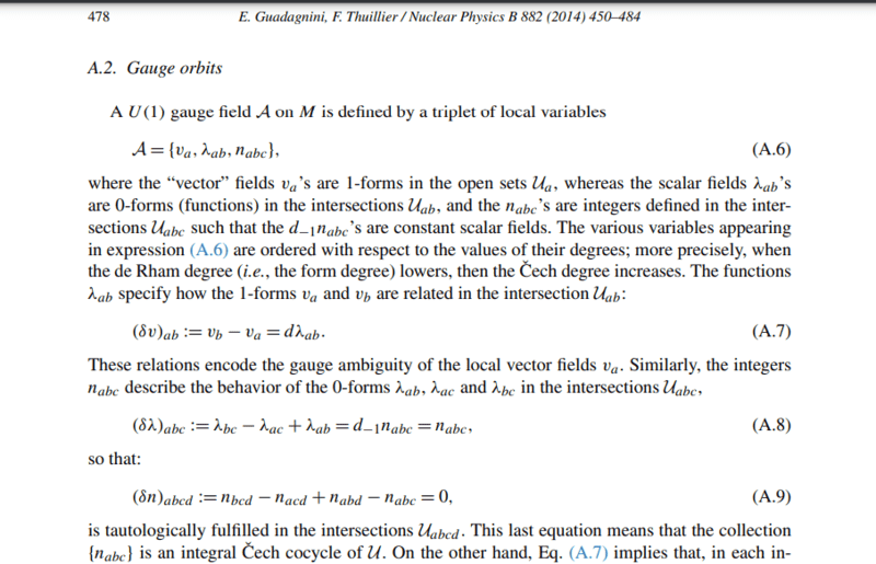

I'm studying Chern-Simons theory on topological nontrivial 3-manifold (I come from a physics background, so I'm new to some mathematical concepts). If the first homology group $H_1(M)$ is nontrivial one needs to consider a good cover of the manifold and a polyhedral decomposition. Then, we can define a U(1) gauge field as follows:
1. Why if the homology group is trivial i can take $d\lambda_{ab}$ so that $v_a=v_b$, without speaking of bundles?
On the other hand, in the language of bundles, if the manifold is globally trivializable (so admits a global section) the connection could be described by 1-form globally defined.
2. Why if the first homology group is trivial then the manifold is globally trivializable?

here it is:
and this is the paper: https://arxiv.org/abs/1402.3140

Recall from above: "Then one could modify the lambdas, by subtracting these nab and get new lambdas, Lab, which would now themselves be cech 1-cocycles. hence if the 1st cech cohomology also vanishes, these would be cech 1 -coboundaries of form Lab = Lb-La, where the La are defined on the Ua. Then finally subtracting the dLa from the 1-forms va, would give a family of 1-forms that agree on the overlaps Uab, hence would give a global 1-form v."
in this process, finding the L_a, such that L_ab = L_b - L_a, requires the vanishing of 1st cech cohomology, a global statement. This is where H_1(M)=0 is used. The fact that on contractible opens, a closed form is exact does not help. That just says the deRham cohomology of the contractible open set vanishes.
We are not saying that the cech 1 -cocycle L_ab is a deRham coboundary, of form dL_a, rather we are saying it is a cech coboundary of form ∂(L_*)_ab = L_b - L_a.

Okay, here I am. Sincerely it was hard for me to have a deep understanding of some things of the previous answers due to my unfamiliarity with these concepts (i think after the exam i'll come back here to have a better understanding), but the last answer was extremely helpful. I'll try to give a (hope not over)simplified picture of what I understood about the intial question, if you want let me know if it's correct, even if not so formal.
In order to study the gauge theory on a nontrivial manifold we have to consider a good cover (every open set and intersections are contractible) and a triangulation (associate vertex to open sets, edges to intersection and so on), obtaining a simplicial complex. Combination of n-simplexes with boundary operator gives us a "Cech" complex: dual to this is a cochain complex obtained assigning p-forms to each sets and intersection. So we have two boundary operator: the exterior derivative and the Cech coboundary (illuminating quote: "the deRham coboundary is zero if the form is closed, and the Cech coboundary tells you something about compatibility of the forms on overlaps of their open sets").
Now: we can start assigning a 0-cochain 1-form valued to every open set. If the Cech coboundary is trivial, this means v_a=v_b in the intersection and so it's a global 1-form: this is the case of the homology sphere, indeed for the argument of the double complex in this case cech, de rham and singular cohomologies (which is dual to real singular homology) are the same, and then vanishes. But if the cohomology is not trivial, the coboundary is v_b-v_a=l_{ab} (where l_{ab} it's a 1-cochain 0-form valued not yet specified).
Here it comes the crucial part. You said:
"under the assumptions that the 1-forms va have a Cech 1-coboundary vb-va which is exact (= dLab), in particular that Cech 1-coboundary has values in the closed 1-forms, then the Cech 0-cochain (dva) with values in 2-forms, has Cech 1-coboundary equal to zero, hence (dva) defines a global 2-form which is locally exact, hence a global closed 2-form."
In the beginning I was trying to understand why v_b-v_a should be an exact form, but it seems now that it is an assumption made to obtain a global closed 2-form, as Chern Simons theory wants. Indeed, if we simply want dv_a=dv_b => d(v_b-v_a)=0, so l_{ab} should be a closed form.
If the last statement it's correct, I have one last question: the reason why l_{ab} it's not only closed but also exact, is due to the fact that it is defined on a contractible open set (the intersection), so every closed form is exact? (I know, you said that this doesn't help, but I can't think to other reasons)
yes, on a contractible set, closed and exact forms are the same. i.e. closed is the same as locally exact.
