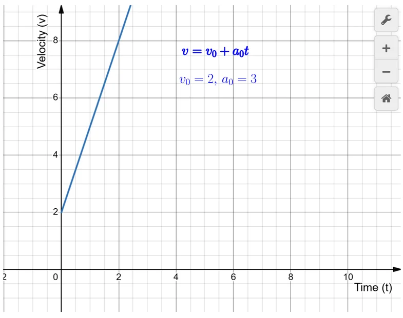

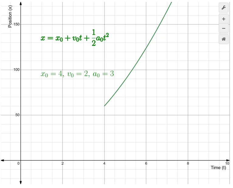

Problem Statement :
For a particle moving in one dimension along the ##x## axis with constant acceleration ##a_0## (see figure alongside), the three well known equations of high school kinematics are ##(1)\; v_(t)=v_0+a_0t\quad (2)\; x(t)=x_0+v_0t+\dfrac{1}{2}a_0t^2\quad \text{and}\quad\boxed{(3)\; v^2(x) = v^2_0+2a_0(x-x_0)}##. These equations can be derived using the methods of (1) algebra and (2) calculus - and I have been able to do it [I would be happy to provide the details if asked]. Additionally, there's a third method, the method of graphs. I have been able to derive (1) and (2) using the graph depicting ##v(t)-t##, its slope and the area under the straight line lead to (1) and (2). [I would be happy to provide the details if asked].

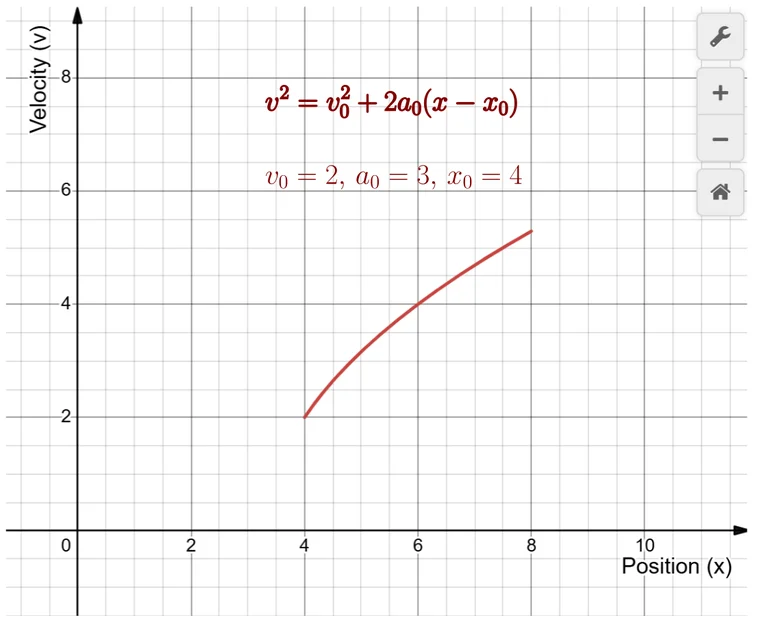

I am stuck with (3). Knowing it already (or beforehand), I can see that the graph of ##v(x)\;\text{versus}\; x## will be a parabola that "curves" with a decreasing slope ##-## an attempt of which I have made in the graph alongside. But that doesn't help. It is "how" to derive the equation using graphs where I am at a loss. More specifically, which graph to use? It cannot be the one I have shown, for it was sketched using the equation that I seek to derive. I am left with ##v\;\text{versus}\; t## graph which is a straight line, or the ##x\;\text{versus}\; t## graph which is parabolic. For reference, I put both graphs to the left.
Can either of the two graphs above be used to derive (3), namely : ##v^2(x)=v^2_0+2a_0(x-x_0)##?
Many thanks.

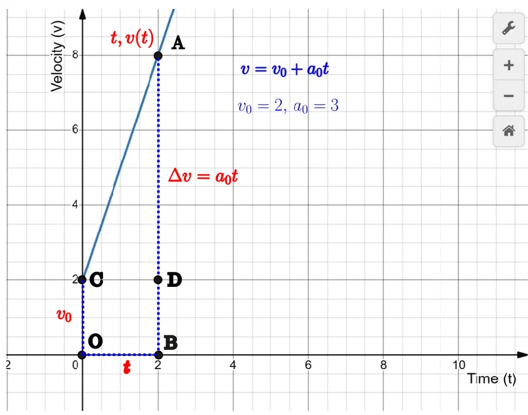

As @Ibix remarked, some algebra is inevitable when you translate a graphic form into an algebraic form. Here is the simplest way I can think of to do this using a velocity vs. time plot (see figure on the right).
Total distance ##x## traveled in time ##t## is "the area under the curve", in this case the area ##A_1## of the red triangle plus the area ##A_2## of the yellow rectangle.
Note that the acceleration ##a## is the slope, $$a=\dfrac{\text{rise}}{\text{run}}=\dfrac{(v-v_0)}{t} \tag{1}.$$ The areas are ##A_1=\frac{1}{2}\left({v-v_0}\right)t~## and ##~A_2=v_0t~## so that $$x=A_1+A_2=\frac{1}{2}(v+v_0)t. \tag{2}$$Multiply equations (1) and (2) to get $$ax=\frac{(v-v_0)}{t}\times\frac{1}{2}(v+v_0)t \implies 2ax=v^2-v_0^2 $$ QED.

brotherbobby said:
which graph to use?
Obviously, you should use a graph of ##v^2## vs ##x##. That will give you the point-slope form of a straight line ##(y-y_0)=m(x-x_0)## where ##y=v^2##, ##m=2a##, and ##x=x##. You can just directly read it off the graph.

I am the OP of this thread, sorry coming in almost two days late. I have read some of the posts of the thread and the best way to clear the doubts is to show you what I have been able to do so far. But first I must start with the problem statement.
Statement of the problem :
The third of the well known equations of constant acceleration kinematics relates velocity to displacement thus : ##\boxed{(3).\; v^2(x) = v^2_0+2a_0(x-x_0)}##. Please see the figure for the symbol details.
I have been able to derive this relation (3) using both algebra and calculus (separately). The latter involved noting that the (constant) acceleration ##a_0 = v\dfrac{dv}{dx}##, a point you'd sometimes miss in the older textbooks. So far so good.
Additionally, I have been able to derive the two earlier equations using graphs, namely ##(1)\; v(t)=v_0+a_0t,\quad (2)\; x(t)=x_0+v_0t+\dfrac{1}{2}a_0t^2##. Let me give you the details in brief.
(1) Let's imagine the graph alongside was drawn from data. We are required to find the equation from it. Since the slope of a ##v-t## graph is the acceleration and that is a constant here ##(=a_0)##, we can take a point on the graph ##(t,v(t))##. From the equation of a line, ##y=mx+c\Rightarrow \boxed{v(t)=v_0+a_0t}\quad(1)##, where the ##y## intercept of the line ##c = v_0## here.
(2)
For (2), the graph is the same ##v-t##, with the points laballed. The net displacement ##\Delta x = x-x_0## is the area under the ##v-t## curve. Which is the area of the trapezium OCADB. The area of a trapezium is ##\small{\dfrac{1}{2}\times(\text{sum of parallel sides})\times(\text{height}) = \dfrac{1}{2}(v_0+v(t))\times t= \dfrac{1}{2}(2v_0+a_0t)t=v_0t+\dfrac{1}{2}a_0t^2\Rightarrow \boxed{x=x_0+v_0t+\dfrac{1}{2}a_0t^2}\quad (2)}##
(3) I follow @Dale 's suggestion (post #5, above), with a slight change - plot ##v^2 - (x-x_0)##. I use the values, ##v_0=2, a_0=3, x_0=4##, and plot ##v^2(x)=4+6(\Delta x)## in the graph alongside. Of course ##x-4>0## and ##v^2 = y>0##. Clearly, ##v^2## varies linearly with ##x## and ##v_0^2=4##. Needless to say, the formula to be derived is being used to plot this graph, imagining that this is not the case and raw data was instead available. That aside, how does one show that the slope of this line is equal to ##2a_0##? The slope ##m = \dfrac{10-4}{1-0} = 6##. Assuming from the raw data the value of the acceleration can be obtained ##(a_0 = 3)##, we can say that the slope turns out to be ##2a_0##. In that case, ##\dfrac{v^2-v_0^2}{\Delta x}=2a_0\Rightarrow\boxed{v^2=v_0^2+2a_0\Delta x}\quad(3)##.
I don't know if there's a better way. It just feels contrived and less convincing than deriving the earlier equations.

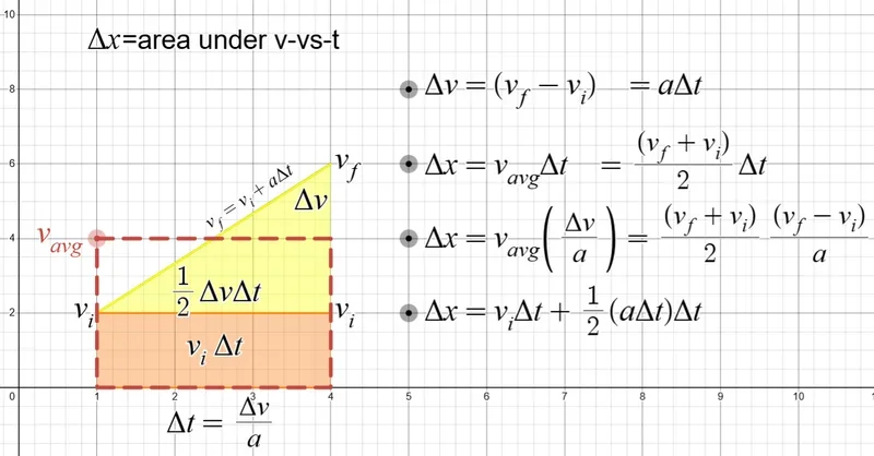

A variant of this proof is visible in this v-vs-t graph of mine from another thread https://www.physicsforums.com/threads/interval-kinematics.1084824/post-7306987
See my desmos.com/calculator/00069a84c7
  • ##\Delta x##=Displacement=(Area under v-vs-t )=(Area under ##v_{avg}##-vs-##t##)=##v_{avg}\Delta t##=(Area of red-rectangle).
  • For constant-acceleration, ##v_{avg}=\displaystyle\frac{v_f+v_i}{2}## and ##\Delta t=\displaystyle\frac{v_f-v_i}{a}##.
