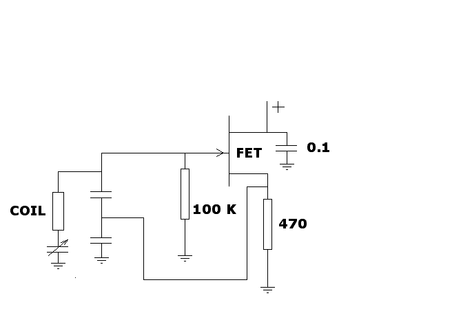

When you get to the DC biassing, have a look at the attached picture.
The source resistor is a critical component in this because it is directly across one of the capacitors in the feedback network. You also have to take your output from across this resistor. Its value depends on the FET.
Some versions of this circuit show a RFC (Radio Frequency Choke) in series with the source resistor. This is an untuned inductor of about 1 mH.
This circuit is notoriously difficult to get going and it has various other names that are similar to its proper name. None of them are complimentary.
Especially, the two series capacitors need to be chosen so that they have less reactance than the tuning capacitor for stability, but not too much less or the oscillator will not oscillate.
If you do get it going, it is quite a stable oscillator.

This circuit is an oscillator. That means it generates AC but has to be supplied with DC power.
The output would be taken via a series capacitor from the top end of the source resistor
This circuit would not normally be used at 2.43 GHz, but it may work in a simulator.
It would normally be used between 3 MHz and 12 MHz, roughly. It would certainly need the DC conditions to be right before it oscillated.
For oscillation at about 6.5 MHz, values like 10 uH for the coil, 100 pF for the tunable capacitor and 300 pF for the series capacitors might get you somewhere near oscillation. Then you can adjust the variable capacitor to see what sort of frequency output you can get.

The resonant frequency is that of the inductor with 3 capacitors in series across it. You know the formula for capacitors in series.
There is a standard formula for working out resonance.
It is F = 1 / (2 * pi * Square root of { L * C } )
A convenient form of it for RF is as follows:
F = Square root of {25330.3 / (L * C)}
where F is in MHz... C is in pF ...and L is in uH
eg if C =60 pF L = 10 uH then F = 6.5 MHz
If you use an enhancement mode Mosfet you will need to forward bias it by about 2 volts relative to the source.
Clap oscillator will work fine at a few MHz, but at 2.4 GHz, transmission lines and resonators are used. Transistors are modeled as two-port networks with s-parameters, need to do impedance matching, get Rollets' stability factor for starters etc
