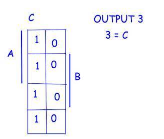

So for the first Karnaugh would this be right? its for the first ouput.
Since you have not defined what "first output" means, I wouldn't know. Do you mean the most significant bit or the least significant bit? Do you see how that designation is more meaningful than "first output" ?

Output1
Equation: A/B/C
Output2
Equation: /AB+A/BC+B/C
Output3
Equation: C
To put all this together I do this ? C + (/AB+A/BC+B/C) + (A/B/C)
l
Your equations at a quick glance appear (1) wrong, and (2) ridiculously complex.
For example, #3 obviously should be 3=C
You K-maps look nothing like what I am accustomed to. Is that how they are done these days? Here's mine.

Alternatively, you could determine the logic by examining your table. Looking at output 2,
we see it's 1 when A=0,B=1,C=? and also when A=1,B=0,C=1 and when A=1,B=1,C=0
This gives rise to the equation: O2 = A' B + A B' C + A B C'
and maybe this can be simplified further.
By inspection, you can see that whenever C is 1 then O3 is 1, so we can write O3 = C, as phinds found.
