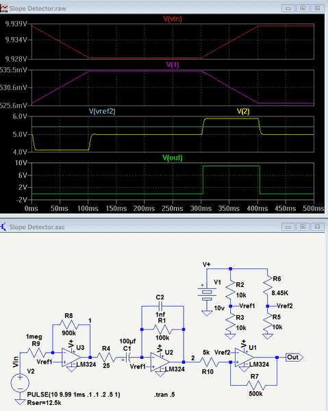

I want to detect whether potentiometer output voltage is increasing or decreasing and convert this to a digital signal.
the circuit must be able to sense tiny voltage changes (order of 10mV) and with high speed.
all I am interested is if Vout increases or decreases not by how much
increasing V =high output
decreasing or stable V =low output
how can i achieve this?

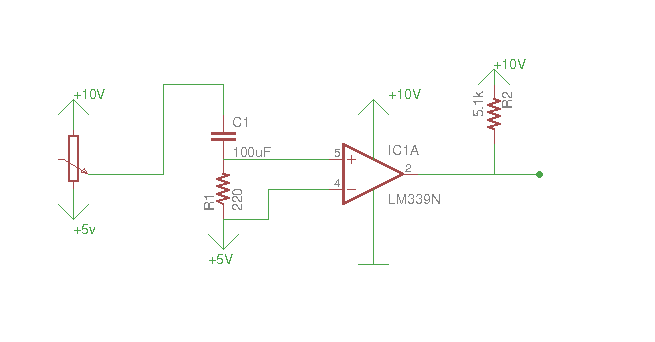

will this circuit work , how do i improve it

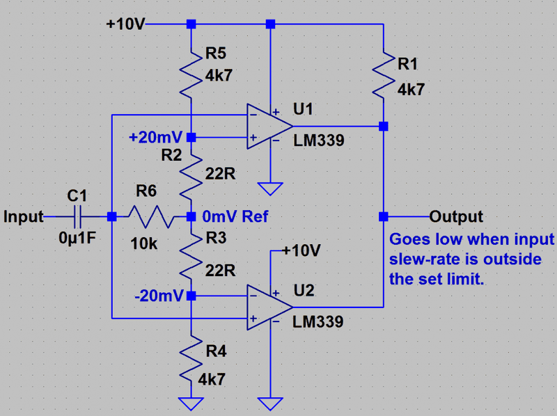

You should be using feedback in pretty much any opamp circuit. Look up "opamp differentiator" to find what you are looking for... :smile:
Your example circuit will oscillate and amplify any supply noise.
A differentiator circuit will detect the slew rate of the voltage from the pot. It will not detect slow changes of absolute voltage.
You need to use a window detector. https://en.wikipedia.org/wiki/Window_detector
The LM339 is a comparator with a positive internal feedback of a few mV.
well, for a start, the DC voltage from the pot isn't going to go through C1
you said you wanted a digital signal ... that isn't going to produce it
You need an ADC chip followed by a microprocessor to work on that data or use a PIC or micro of your choice that has an ADC built inD
My previous post assumed you wanted to detect any change. "detect increasing or decreasing pot output".
This circuit only detects a rising voltage.

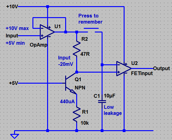

How the circuit works.
If not yet buffered, this circuit uses op-amp U1 to buffer the potentiometer output voltage.
Q1 and R1 with the +5V supply makes a current sink of about 440uA. The 440uA flows through resistor R2=47R and so drops about 20mV from the buffered input voltage.
That slightly lower input voltage is compared with the set voltage. If the input rises by more than 20mV then the comparator U2 output goes high. U2 must have very low input bias current so it needs to be a CMOS or JFET input comparator or possibly an op-amp.
Changing the value of R2 will set the rise above the set voltage before detection. R2 can also be adjusted to compensate for the offset voltage of U2. Maybe R2 should be a 200 ohm trimpot.

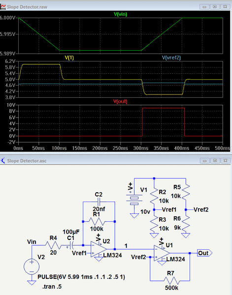

Below is the LTspice simulation of my take on a circuit.
It uses an opamp differentiator circuit to convert the slope change into about a 1V step signal to minimize offset effects. This goes to an opamp comparator circuit to give the desired positive pulse output for a positive slope on the input, and zero volts otherwise.

That circuit won't detect the polarity of the voltage change.
True, my first circuit actually detects both polarities of change, then ORs them together. If you separate the outputs you get two independent outputs, one for a rise, the other for a fall.

So talk about using an opamp differentiator circuit followed by some other circuitry. What would that look like, and how would you design it to reject noise and have the desired logic level output?

The modified circuit is shown below:
The added buffer at the pot output is configured as an inverter since the LM324 has a maximum output of about 9V when used as a non-inverting buffer and a 10V supply.can i use lm358 in place of lm324?

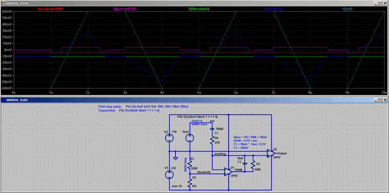

Attached is an LTspice model. Strip the .txt extension to run the simulation.
To make model plots easier I redefined power supplies (0V,+5V,+10V) to (-5V,0V,+5V).
Use any op-amp you have. Op-amp inputs are close to mid-supply.
You could even use comparators in place of the op-amps.
A "Threshold" of about 10mV is set by R2 with the 200 ohm trim-pot, R3.
Mid-position is about 10mV.
The offset voltages of U1 and U2 are also eliminated from the threshold value by the setting of R3.
Slow changes in pot voltage are followed in C1.
When stable, the voltage at bottom of C1 = "tracking", will be close to the "threshold" voltage.
Slew rate of "tracking" is limited by 5V/R1 = 50uA, with C1 = 500uF, it sets 100 mV/sec.
C2 and R4 quieten the U1 op-amp output when pot voltage is stable.
Otherwise U1 produces a +/-5V signal while following a changing pot voltage.
C2 and R4 are not needed if a comparator is used for U1.
Any positive pot voltage step over 10mV will be immediately detected by U2 going high.
Any pot slew rate rising faster than +100 mV/sec will outrun "tracking".
Once that "tracking" error has accumulated to greater than 10mV, the output of U2 will go high.
Note that for slowly rising voltages, eg for +120mV per sec, it will take 0.5 sec before detection.
50uA will flow in C1. It needs a simple non-inverting follower or buffer from the pot to C1.
Since the input voltage might be close to +5V, a rail-to-rail op-amp is probably needed for the buffer.

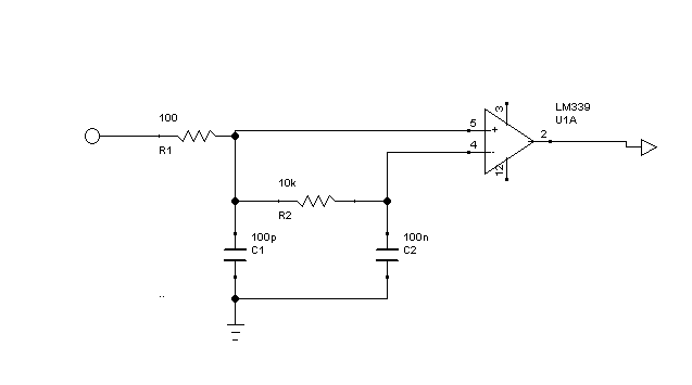

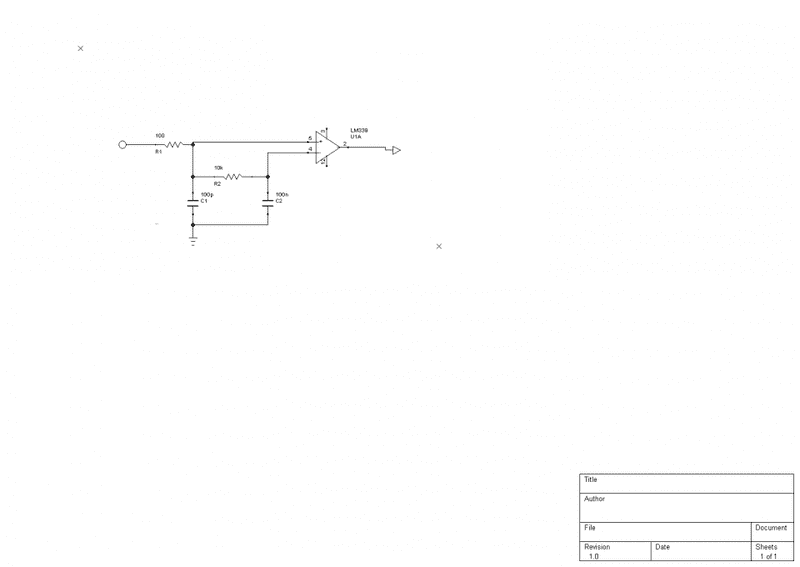

On the other hand, here is a circuit that I have used in the past:
The R1-C1 combination is a noise filter, the R2-C2 combination acts as a time delay circuit. The values given are just examples, modify them at will.
For a stable input signal, would the output be high, low or would it drift ?
How could you calibrate it to only detect positive slew rates over +100mV/sec ?
  • My schematic was just a sketch - of course there must be some adjustments, one of them being an adjustable offset to avoid problems with a stable input signal.
  • As to only detecting positive slew rates over +100mV/s, that is the purpose of R2-C2. If C2≈0, the comparator will never detect anything, if C2 is too large, it will detect all positive changes.
