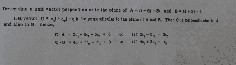

Determine a unit vector perpendicular to the given planes
11 replies · 3K views · last reply
chwala
2,854
436
see attached.
vectors
Printed problem: determine a unit vector perpendicular to planes A = 2i - 6j - 3k and B = 4i + 3j - k; equations C.A = 2c1 - 6c2 - 3c3 = 0 or (1), and C.B = 4c1 + 3c2 - c3 = 0 or (2).

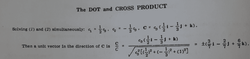

Printed page titled The DOT and CROSS PRODUCT showing a worked solution: c1 = c3/2, c2 = -c3/3, C = c3(i/2 - j/3 + k), then the unit vector C/|C| = ±(3/7 i - 2/7 j + 6/7 k).
I looked at this question and i wanted to ask if we could also use; ##C## =## c_2 ##(##-\dfrac {3}{2}i## +## j - 3k)## ... cheers
This problem can also be solved by using the approach of cross product ##A×B##...
They're asking for a unit vector, so you will need to solve for ##c_2##. Doing so will give you exactly the same two vectors as shown in the solution.
I understand that...I just wanted to be certain that we could work with any ##c_1, c_2## or ##c_3##...thanks...working to the given solution is straightforward.

Because you wrote "##C = c_2 (-\dfrac {3}{2}i + j - 3k)## and it needs to be a unit vector. There are only two values of ##c_2## that make this a unit vector: one positive and one negative.
What i meant;
The unit vector in the direction of c can also be given by;
##±\dfrac{{-\frac {3}{2}}i+j-3k}{\sqrt \frac{49}{4}}...##
using either ##c_1, c_2## or ##c_3## would work as indicated in my post ##3##.
chwala said:
What i meant;
##±\dfrac{{-\frac {3}{2}}i+j-3k}{\sqrt \frac{49}{4}}##
Yes, but why would you want to write it this way without simplifying it? Dividing by ##\frac{49} 4## is equivalent to multiplying by 2/7. If you do this, you get the same result as shown in the solution.
Yes of course I can simplify that! ...I was just indicating to you on what I meant...we shall end up with same solution...
Cheers Mark. Thanks.
I did check and confirmed that the problem can also be solved by using cross- product...where ##A×B=15i-10j+30k## ...
My only query was specific on ##c_1,c_2## and ##c_3##...Cheers
