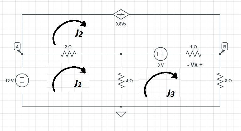

Hi all !
I want a confirmation for this exercise please.
The circuit:
This is my try: https://www.docdroid.net/EFuTDMp/new-doc-2019-10-03-234340-1-converted.pdf
Thanks
I only looked at your first loop equation and it appears to me that you have the sign of the fixed voltage wrong.
OOPS strike that

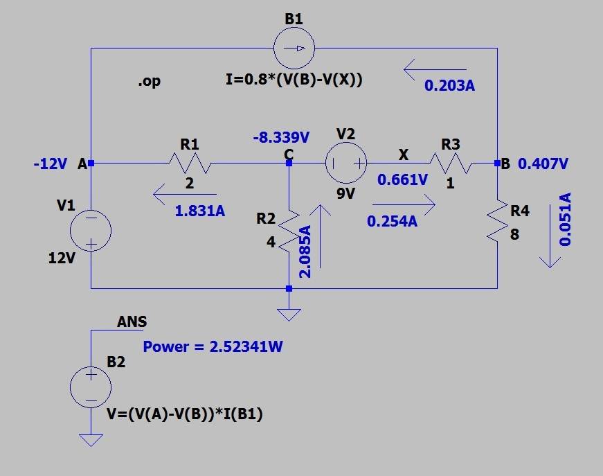

Hand calculation is too difficult for me, I would rather resort to simulation.
