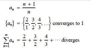

I attached the solution to the problem.
I can see that the infinite series diverges by looking at a few terms, but how would I find a general term for the infinite series, to evaluate it analytically?
  • Handwritten-style math: a_n = (n+1)/n; the sequence {a_n} = {2/1, 3/2, 4/3, ...} converges to 1; the series sum from n=1 to infinity of a_n = 2/1 + 3/2 + 4/3 + ... diverges.
If your goal is to prove that the series diverges, you don't necessarily need to find an expression for the general term (by which I assume you mean the n'th partial sum).
There is a very simple test which you should always apply as the first step. If this test fails, the series diverges. What test am I referring to?
