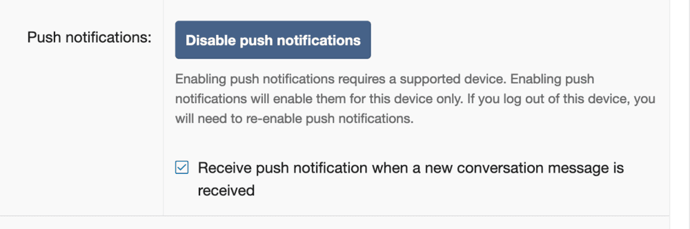

Maybe this is relevant. You will find it under My PF/Preferences

Yea that was already enabled, but as I said no big deal I'll just double check always.Back to the task at hand, xmax
