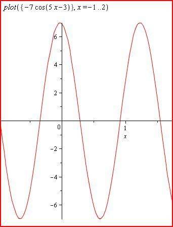

1. f(x)= -7cos(5x-3)= -7cos5(x-3/5)
cosx is an even function. f(x)=f(-x)
phase difference here is -3/5

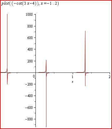

2. g(x)=- cot(3x-4)= cot(-3x+4)=cot3(-x+4/3)
cotx is an odd function g(-x)=-g(x)
phase difference is 4/3

The phase of -7cos(5x-3) is -3/5
No, it is -7cos(5(x-(3/5)), which means that -7cos(5x-3) has a phase lag of 3/5 radians when compared to -7cos(5x).
The phase of is 4/3
Yes, it is -cot(3(x-(4/3)), which means that -cot(3x-4) has a phase lag of 4/3 radians when compared to -cot(3x). Note that this phase lag is greater than the period of -cot(3x), which is ∏/3.
Ratch
The logic here: -7cos(5x-3)= -7cos5(x-3/5), so the phase is -3/5 radians.
The convention is that a positive phase means the given term is lagging. If you say the phase is minus, then it is leading. That is not correct. See plot below.
The logic: -cot(3x-4)= cot(-3x+4)= cot3(-x+4), so the phase looks to be 4/3, but the phase of -cot(3x-4) looks like -4/3, except I am not sure how negative cot influences the phase.
cot(-3x+4)= cot(-3(x-(4/3)) , so yes the phase is 4/3 radians. A negative wave has the same phase as a positive one does.

... Except, again, -cot3(x-4/3) seems to have -4/3 as its phase.
Y 09:44 PM
Put in this form, -cot3(x-4/3)==cot(3(x-(4/3)) shows it has a positive or lagging phase. See plot.
Ratch said:
solve,
The convention is that a positive phase means the given term is lagging. If you say the phase is minus, then it is leading. That is not correct. See plot below. Ratch
