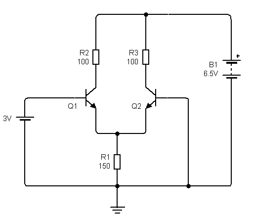

I want to learn more about Op-Amps and amplification so I am making a simple differential amplifier. The circuit looks like this...
Schematic of a BJT differential amplifier: +V supply through Rc1 and Rc2 to collectors of Q1 and Q2, Vout taken between the collectors, Vin+ and Vin- at the bases, common emitter resistor Re to -V.
I set it up and it isn't working correctly. First I tried putting 3 volts for Vin+ and ground for Vin-, and the voltage across Vout was around half a volt. I don't understand this result. Shouldn't it be an amplification of the difference in voltage? (Which is 3 volts correct?) How can I get half a volt? I didn't know what value of resistors to use so I used 100 ohm for RC1 and RC2 and 150 ohm for Re (Completely arbitrarily chosen).
Can anyone help me out?
Thanks!

In my original post I said...
V+ = 3V
V- = Ground
Re = 150 ohms
And the other two resistors are 100 ohms.
EDIT: Ohh and I am using a 6.5 volt power source, if that is what you meant. Sorry!
Xyius,
You need to be more specific. Do you have v+ at 6.5V and v- at 0V, or do you have v+ at 0V and v- at -6.5V (or something else). Also, when you say the input is 3V where exactly are you measuring. In other words, what node are you assuming to be 0V (where are you putting the black lead of your meter when you are putting red lead on Vin and seeing 3V).
Sorry about the ambiguity. As you can probably tell I am new at this!
The way I have it set up is. I put the positive lead of the 6.5 volt battery (It WAS a 9V but I have been using it for awhile..) for V+ and I put the ground for V-. As for the inputs, I put the positive lead of the 3V battery on one of the inputs and the ground to the other input. When measuring V+ and V- my black lead is on the ground for that battery, and likewise for the 3V power source.

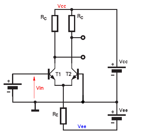

This is how you should set your differential amplifier.
Circuit schematic of a BJT differential amplifier with two NPN transistors T1 and T2, collector resistors RC, emitter resistor RE, supplies Vcc and Vee, and input source Vin.
You need to use two battery one for Vcc and second one for Vee.
Also kept in mind that the linear region for BJT differential amplifier is very small.
If +Vin - (-Vin) = is greater then 150mV the one of a bjt will be in cut-off and the second one will be in saturation.

If I understand your post correctly you have build this circuit
Schematic of a two-transistor circuit with NPN transistors Q1 and Q2, collector resistors R2 and R3 (100), emitter resistor R1 (150) to ground, a 3V source on Q1's base, and a 6.5V battery B1 on the collector supply rail.
If so. This circuit has nothing to do with real differential amplifier.
Q2 is in cut-off and Q1 is in active region.
Circuit schematic of a BJT differential amplifier with transistors T1 and T2, collector resistors Rc, emitter resistor RE, supply rails Vcc and Vee, and input Vin applied to the base of T1.
Thank you very much! I will study this later and try to re-create it. I just have a few questions..
1.) What roles to the values of the resistors play? What values should I use?
2.) Same question, but for the batteries.
3.) Why is it that one BJT will cut off and one will be in saturation after a 150 mV difference? Would that mean that one BJT is doing all the work while the other is doing nothing?
Thanks again!
Well the resistor sets various of the amplifier parameters. The most important one is of course the voltage gain. But also the proper DC bias point is also important.
For example if you use two 9V batteries then. It is good to have:
Rc = (0.5*Vcc)/Ic and Re = (Vee - Vbe)/ (2Ic)
So for example
Rc = 4.5V/4.5mA = 1KΩ
And
Re = (9V - 0.65V)/9mA = 920Ω ≈ 1KΩ
I use Vcc = 9V and Vee = 9V
We use symmetric power supply because it is a natural way to power differential Amplifier.
Only in this case we can connect the BJT bases to gnd but we still have bout bjt to work in there linear region. So we made a true DC amplifier.
