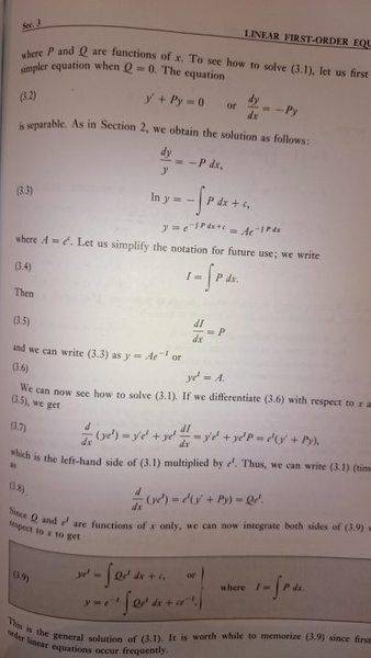

BOAS said:
The method I used is the same (I think) as presented in 'Maths Methods For the Physical Sciences' - Mary Boas, on page 346
It claims that ##y = e^{-I} \int Q e^{I} dx + C e^{-I}## is the general solution to a linear first order differential equation of the form ##y' + Py = Q##
I hope she does not actually say that, because as you have written it, it is either (i) wrong; (ii) inaccurate; (iii) misleading, or (iv) error-prone. What IS true is that the solution of ##y/ + P y = Q## has the form

My mistakes aside, my argument follows fairly closely the steps outlined in the book (see attached).
Could you recommend a more rigorous text? I am concerned that many of the explanations will be of similar calibre.

It is incorrectly explained.
Just an exemple, when she says around (3.3) second scan "We obtain a solution as follows : ##\frac{dy}{y} = -P dx## ... ##\ln(y) = ...## ".
She doesn't know that ##y## does not cancel at some point on the interval of interest. You know it a posteriori, once you have found ##y##.
So she assumes that the solution has no zero without even knowing it, and she uses divisions by ##y## and uses logarithm of ##y## at all points. It is incorrect !

I think the explanation in the text is fine. Sure, you can get really pedantic and point out that the x in the integral isn't the same as the x outside the integral, or when dividing by y, we must assume y doesn't vanish on the interval of interest, etc., but as one of my professors used to say, one should focus on the donut and not the hole.

I realize this probably makes mathematicians cringe, but the book is, after all, intended for physics students.
The notation ##dx## is an abuse of notation that mixes up a function with its image (i.e the identity function ). It makes sense with an explanation. The proof in your book is not an abuse of notation, it is wrong.
The following demo is rigorous, also easier to read in my opinion, and is based on the idea that continuous functions on an interval have primitives that are themselves continuous.
If you assume that a is continuous from ##I## into ##\mathbb{R}##, then there are primitives of ##a## on ##I##. Let ##A## be one of them :
##\begin{align*} y' + ay = 0 &\iff (y' + ay) e^A = 0 \\ &\iff (ye^A)' = 0 \\ &\iff (\exists c \in\mathbb{R} \ ye^A = c) \\ &\iff (\exists c \in\mathbb{R}\ y =c e^{-A} ) \end{align*} ##
If you assume ##b## continuous from ##I## into ##\mathbb{R}##, then ##be^A## is continuous and has primitives on ##I##, ##B## for exemple. So
##\begin{align*}y' + ay = b &\iff (y' + ay) e^A = be^A \\ & \iff (ye^A)' = be^A \\ & \iff (\exists c \in\mathbb{R} \ ye^A = B +c) \\ & \iff (\exists c \in\mathbb{R}\ y = B e^{-A} + c e^{-A} )\end{align*}##

That textbook presentation is inexcusably sloppy---so much so as to be virtually useless.
