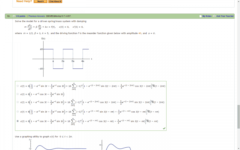

I do not know how to find f(t) with the given Ampliture 40 and a=pi
I have the solution above.
my set up was 1/2y''+y'+5=f(t)
1/2S^2* Y(s) + Y(s)+5=f(t)
Have you studied periodic functions? Do you know how to obtain the Laplace transform of a periodic function?
Here is a brief article discussing how:
http://academic.udayton.edu/LynneYengulalp/Solutions219/LaplacePeriodicSolutions.pdf
From the looks of this does amplitude not matter , only the period?
Wrong. There is an ##f(t)## in the formula for the transform, so everything about ##f(t)## matters.
