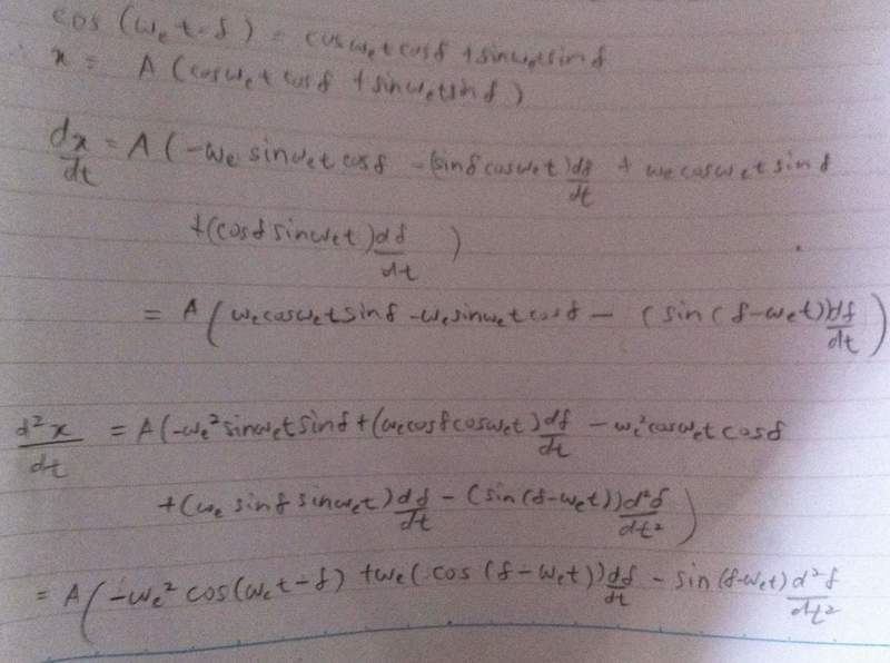

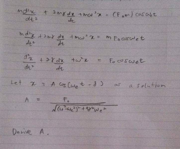

How do I derive A? As you can see in the attachment, I tried to substitute x and expand the equation but I got stuck. How do I get rid of the δ and cos and sin to get the result in the end? Please help!

I would leave (omega*t-delta) alone while calculating the various derivatives. The sines and cosines with this argument do not need expanding until you have done you calculations.

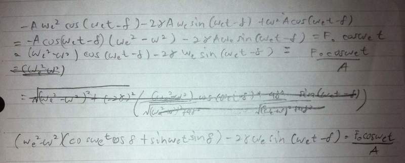

OK, what do I do next? I don't expand it, and here's what I got.
Where did the plain 'ω' come from in the last line of your calculations?
Specifically, the term (ωe^2 - ω^2)?

Now you expand the cosine and sine terms and equate same to the RHS of the equation.
In your first attempt, you differentiated δ w.r.t. time. This was incorrect. The phase angle δ is constant w.r.t. time, which was one reason your original derivation got so unwieldy.

Ok, now what should I do? The right hand side only has cos(w_e*t). And even so, if I did equate the sin and cosine, what should I do with it? I would still have cos(w_e*t) on the right side, don't I?

If you read the attached notes from post#10, you would see how to handle this.

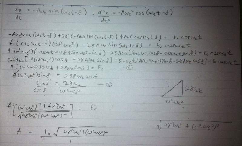

Thanks for the post. That really hepls a ton. But my answer is a little different. How come my denominator and numerator are inverted?
It's hard to tell from your posted calculations. After expanding the cosine and sine terms which contain the phase angle δ, on the LHS there will be sin δ and cos δ terms mixed in with the cos(ωet) and sin (ωet) terms. You use the phase angle triangle to determine sin δ and cos δ in terms of the other known quantities before solving for A.

But in my calculation, I already determined the sin δ and cos δ, see I drew the triangle?

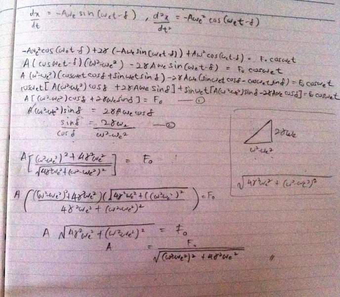

Hey, I got it!Look! Thank you soooo much!
